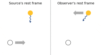

Ibix said:
Direction of light depending on the relative speed of source and detector: https://en.m.wikipedia.org/wiki/Aberration_of_light
Here is the animation from that wiki page:
On the right part of the drawing, the Earth is considered at rest while the star is moving, and the direction of the photon is not affected by its motion, but if a ball had been sent instead of a photon, it would not have reached the Earth since its direction would have been affected by the motion of the star.
Those animations would apply exactly if, say, the star was a gun, the Earth the target and the light ray a projectile. It's pure geometry. If the projectile hits the Earth in one frame, it must hit in the other.
For example, in the animation on the left, why would a projectile inevitably miss the Earth?
The photon's direction is affected by the motion of the star, too. It's moving vertically in the left image and diagonally in the right image. The same would be true of a ball. And if the light pulse/ball/whatever hits the Earth in the left picture it must also hit in the right picture. Otherwise you aren't describing a self-consistent scenario.
Likes PeroK
It would hit the Earth on the left, but miss it on the right, so it would not be symmetrical as it is the case for light.
No. If it hits in one case it hits in both. Otherwise you are describing a circumstance where a ball hits a target according to one observer but not according to another moving with respect to the first. This is self-contradictory. The ball must either hit or not - it can't do both.
I think you need to step back and examine frame changes in simple Newtonian mechanics, because this seems to be where you have the problem.

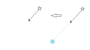

At the right, a ball sent in the direction of the Earth would not hit the earth, it would have to be sent at an angle to the direction of the Earth to account for the motion of the star if it had to hit the earth.
You are misunderstanding those animations fundamentally. They are the same scenario from two different viewpoints. What happens in one must happen in the other. They are not two different scenarios.
You may also be thinking that in the one on the right, the star sees the light move at an angle. But, if you look carefully, you'll see that the star is always directly above the light, which is consistent with the left animation. In the right one, the star has emitted the light vertically downwards in its frame.
And, in the left one, although the light moves vertically from the star's point of view, from the Earths' point of view, the light comes at an angle. And that it what is shown on the right.
On the left, I agree that aberration will change the direction of light seen from the Earth since it is moving, but I think that you take for granted that, at the right, the photons are traveling sideways to their direction to account for the motion of the star. It is not what the animation shows, on the contrary, it shows that the photon is aiming straight at the earth. Photons cannot travel sideways like balls if they cannot add the motion of their source to their own motion.
On the left, I agree that aberration will change the direction the light is seen from the Earth since it is moving, but I think that you take for granted that, at the right, the photons are traveling sideways to their direction to account for the motion of the star. It is not what the animation shows. It shows that the photon is aiming straight at the earth. Photons cannot travel sideways like balls if they cannot add the motion of their source to their own motion.
No. On the right, look at the relative motion of the star and the photon. That photon was aimed vertically from the star. In the star's frame, whichever animation you chose, the photon is aimed in the same direction: Directly down, not towards the Earth.
In any case, both animations show the same photon on the same path.
If a photon were aimed at 45 degrees in the star's frame it would miss the Earth in both animations.
Somehow you need to take a step back and see that that these two animations show precisely the same scenario.
When you say photons can't move sideways you're missing the point that there is no absolute sideways. The sideways motion is entirely due to the relative motion of the star and the Earth. The photon moves in the direction it was emitted. The same physical direction in both animations.
The star has no absolute motion, only motion relative to the Earth. The photons move side ways or not depending on whether the observer has sideways motion relative to the star.
Likes Ibix

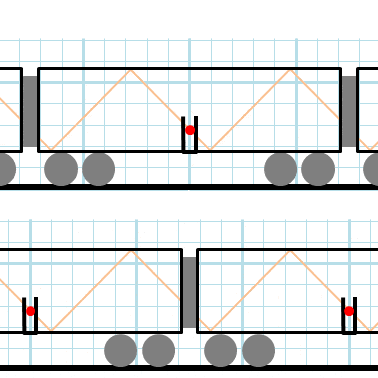

DrGreg said:
Maybe this diagram helps
Here's something (it could be a pulse of light, it could be a ball) bouncing up and down in a train.
An observer in the train (top) infers the thing is moving vertically up and down.
An observer on the ground (bottom) infers the thing is "sliding sideways" in a zig-zag path.
This is valid in both relativistic and Newtonian mechanics.
Likes harrylin
