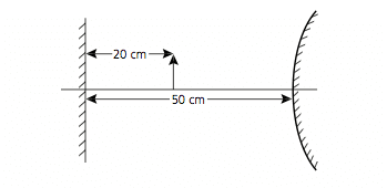

A plane mirror and a convex mirror are placed facing each other and 50 cm apart. A candle is placed on the principal axis 20 cm from the plane mirror, as shown in Figure 17.31. If the distance between the two images in the plane mirror is 40 cm, calculate the focal length of the convex mirror.
M = Hi/Ho = v/u
1/f = 1/v + 1/u
I know I should have attempted a solution, but I read it over and over and I really don't know where to start! Firstly, what does it mean by "the distance between the two images"? Does the image in the convex mirror act as a second object to the plain mirror? I don't know what I'm saying...
Yes, the image in the convex mirror can be considered as a second object in the plane mirror. Try ray tracing to see what is going on.
