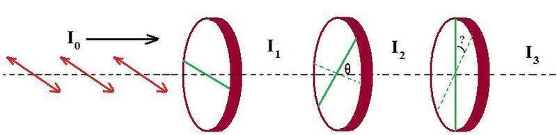

Look at the attached figure which assumes the light is originally polarized horizontally. Go step by step. The green lines show the transmission axis direction for each filter. You have already figured out how the first and last filters must be oriented. So, you just need to find the angle θ for the middle filter such that you get maximum transmission overall.
How would you express I1 in terms of Io?
How would you express I2 in terms of I1 and θ?
How would you express I3 in terms of I2 and θ? Here you will need to think about how to express the angle shown with the question mark in terms of θ.

God thank you guys so much. I still am really unsure of how to formulate this mathematically, but I am going to read over polarizers and see if I can bring any new information to the discussion.

So anyways I thought about this for awhile and this is what I've got
I = Io1Cos(0) = Io1
Then the second polarizer must be positioned at a 45 degree angle relative to the first and the third, which is in the j direction, so
Io2 = Io1Cos(45) = [(2)^1/2]/(2)
But then the next angle is 90, so I think I have two parts of the problem represented properly, but of course the cosine of 90 is zero, so the math there says no light comes through, which doesn't make sense.

Don't forget to square the cosine functions.
The last angle is not 90o. What is the direction of polarization of the light just before it reaches the last filter? What is the angle between that polarization direction and the transmission axis direction of the last filter?

The angle between the polarization filter and the polarized light is 60 degrees. I'm not sure what my problem is.

Not sure how you got 60o. Remember, when light passes through a polarizing filter, the light comes out with its polarization direction the same as the direction of the transmission axis of the filter. So, if you set the middle filter at 45o from the horizontal, then after the light passes through the filter the light will be polarized at 45o to the horizontal. It then proceeds to the last filter (which has its transmission axis vertical). So, what is the angle between the transmission axis of the last filter and the polarization direction of the light that strikes the last filter?
45 degrees, I think.
That's right. So if you set the middle filter at 45o you should be able to find the final intensity in terms of the initial intensity Io.
For comparison, also see what you get if the middle filter is set at 30o.

It turns out that the most light that comes through is if each angle is 60 degrees. I still don't fully understand the logic though.

I don't think it's 60 degrees. Remember, the three angles must add to 90 degrees. But, the correct answer is not what I originally thought! My intuition was faulty. :redface: I mistakenly thought that it would be best to align the first filter in the [itex]\hat{i}[/itex] direction (the initial polarization direction of the light). But that's not so. Sorry for not seeing that.
As in the solution that you posted as an attachment, let ##\theta_1## be the angle of the first filter with respect to polarization of the incident light, ##\theta_2## the angle of the second filter with respect to the first filter, and ##\theta_3## the angle of the third filter with respect to the second. We have the condition that the sum of the three angles must be 90o.
The final amplitude of the electric field will be
##E_{final} = E_{initial} cos\theta_1 cos\theta_2 cos\theta_3## .
Note that this expression is completely symmetric in the three angles. So, if there is a unique answer for the angles that maximize ##E_{final}##, then the answer must be that all three angles are equal. Using the fact that the angles add to 90o then gives the answer. But we had to assume the answer is unique.
Your posted solution finds the answer graphically.
Another way to get the answer is using calculus to find the angles that maximize ##E_{final}##. Letting ##\theta_3 = 90^o - \theta_1 -\theta_2## you have
##E_{final} = E_{initial} cos\theta_1 cos\theta_2 cos(90^o - \theta_1 -\theta_2)##
or,
##E_{final} = E_{initial} cos\theta_1 cos\theta_2 sin(\theta_1 +\theta_2)##
A maximum occurs where the partial derivatives of ##E_{final}## with respect to ##\theta_1## and ##\theta_2## are both equal to zero. You can show that this will lead to the condition that ##\theta_1 = \theta_2##.
You could then start over letting ##\theta_1 = 90^o - \theta_2 -\theta_3## to write ##E_{final} = E_{initial} cos\theta_2 cos\theta_3 sin(\theta_2 +\theta_3)## and show that maximum requires ##\theta_2 = \theta_3##.
Hope this helps.
