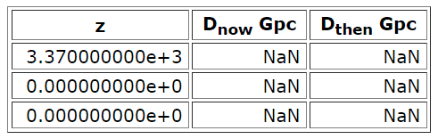

pbuk said:
Please note you should see "LightCone v8.1.1 | CosmicExpansion v1.1.0" at the bottom of the web page, if not hold shift and click the refresh icon (or hit Ctrl-F5).

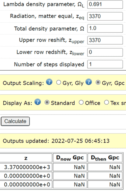

None of these works for me. Please help!
The old LightCone8 gives me the following:

JimJCW said:
P.S.: I changed browser. It worked like you said. It could be cache problem.
Yes: the browser caches the back end calculation module for 1 week. We could change this by requesting a specific version of the back end module rather than the latest version, and probably should.

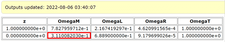

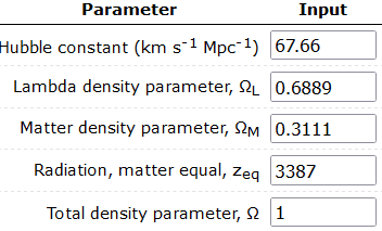

We have just activated LightCone v8.2.0. with the Planck 2018 Baseline Dataset as default and also the Base+ BAO as an option. Link in my sig (remaining the same)

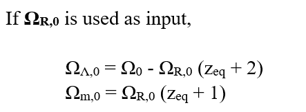

Using ΩΛ,0, Ωm,0, or ΩR,0 as input:
We can use anyone of the three Ω’s as input, but not more than one. This is because they are related by two equations:
Given the value of anyone of them, the values of the other two are determined by the above equations:

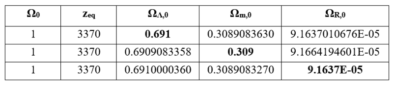

As examples, if we set Ω0 = 0 and zeq = 3370, we get the following results, with input quantities boldfaced:
Yes indeed. This is implemented in the back end calculations like this:
  • ## z_{eq} ## must always be provided
  • if ## \Omega_{\Lambda,0} ## is provided it uses that to calculate ## \Omega_{m,0} ##, otherwise ## \Omega_{m,0} ## must be provided*
  • ## \Omega_{rad,0} ## is calculated from ## \Omega_{m,0} ##

However note that only ## \Omega_{\Lambda,0} ## is currently editable in the UI.

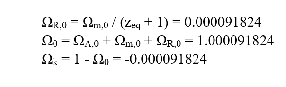

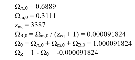

I think LightCone8 uses the following six parameters: H0, ΩΛ,0, Ωm,0, ΩR,0, Ωk,0 (= 1 - Ω0), and zeq.
If the values of H0, Ω0, and zeq are set as being done in LightCone8, we need the values of ΩΛ,0, Ωm,0, and ΩR,0 to make various calculations. We can only use one of them as input because the values of the other two parameters are determined by the following relations (see Post #13):
If we really want to use both ΩΛ,0 and Ωm,0 as inputs, we can change zeq to a derived quantity and use the following equations to find the values of Ω0 and zeq from ΩΛ,0 and Ωm,0:
Note that it will be very hard to get Ω0 = 1 in this case.

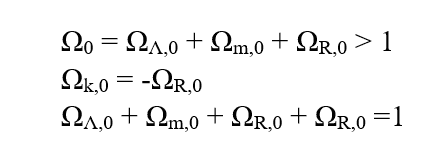

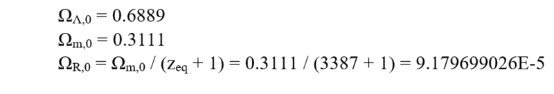

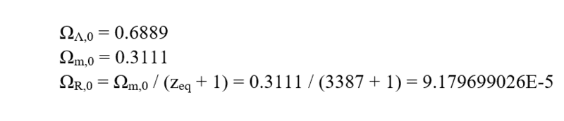

In Planck 2018 results. I, in both Tables 6 and 7 and for both cases of ‘Planck alone’ and ‘Planck + BAO’,
ΩΛ,0 + Ωm,0 = 1
It seems we don’t need to use both ΩΛ,0 and Ωm,0 as inputs at the same time.
I think LightCome8 is functioning properly using ΩΛ,0 and zeq as inputs. It calculates Ωm,0 and ΩR,0 in the program correctly (see Post #148 of the thread, A glitch in Jorrie’s Cosmo-Calculator?). It can also be demonstrated that the calculation results from Lightcone8 and ICRAR are consistent (see Post 153 of the thread mentioned):

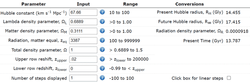

LightCone8
ICRAR
z0.020.02
Scale (a)9.803921569E-019.803921569E-01
T Gyr1.351246087E+011.351276116E+01
R Gpc4.384362823E+00
Dnow Gpc8.810076113E-028.810076113E-02
Dthen Gpc8.637329523E-028.637329523E-02
DHor Gpc4.384362823E+00
Dpar Gpc1.381871578E+01
Vgen/c9.896208856E-01
Vnow/c1.990692361E-02
Vthen/c1.970030737E-02
H(z)6.837765717E+016.837765717E+01
Temp K2.779989600E+00
rho kg/m38.782193743E-278.782799071E-27
OmegaM3.217304253E-013.217304253E-01
OmegaL6.781722253E-016.781722253E-01
OmegaR9.734946123E-059.734946125E-05
OmegaT1.000000000E+001.000000000E+00

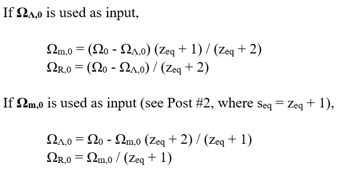

If we want, we can put the calculated ΩR,0 value as output under ‘Matter density parameter, Ωm’,
If we want, we can also use Ωm,0 and zeq as inputs instead of ΩΛ,0 and zeq (see Post #13 of this thread).
ΩΛ,0 + Ωm,0 = 1
If ΩΛ,0 and Ωm,0 are treated as inputs at the same time, using PLANCK(2018+BAO) data as an example, we will have the following:
Note that the space is not flat in this case.
Some of the above numbers can be obtained using LightCone8:
Ω0
z
zeq
OmegaM
OmegaL
OmegaR
OmegaT
0​
3387​
0.311008203​
0.6889
0.000091797​
1​
1.000091824
0​
3387​
0.3111
0.6889
0.000091824​
1.000091824​
@Jorrie, @pbuk

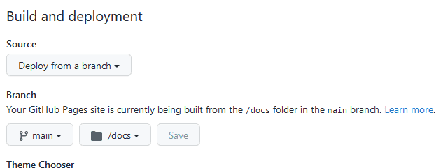

Jorrie said:
I'm still unsure on how to give other interested Forum members a link to run the IO variant without bumping it up.
The best I could figure is to give then this Github url from where they can click "code" and then download a ZIP for installing a directory on their own computer and then run the .exe...
Is their a simpler method to give them a run-able version link?
Yes, if you got to your repo at https://github.com/burtjordaan/light-cone-calc.github.io and select Settings -> Pages, then make it look like this:
You should then (after a short delay to build it) see your version of the site at https://burtjordaan.github.io/light-cone-calc.github.io
Discrepancy in LightCone8.1.2 – Jorrie:
When running LightCone8.1.2 – Jorrie using PLANCK(2018+BAO) data, I noticed that the input value,
Ωm,0 = 0.3111​
is changed in output:
Ωm,0 = 0.3110082030​
For a related discussion, please see Post #25.
@Jorrie, @pbuk
  • #31
This is as expected. See my post #26. Either Ωm,0 or ΩLambda,0 has to give if we want to keep OmegaT,0=1.
Likes pbuk

pbuk said:
Note that with the current settings @Jorrie's development fork is served at https://burtjordaan.github.io/light-cone-calc.github.io/docs/.
Thanks for providing the runable link, because I still have finger trouble with Github. Note that this is not the latest version, which JimJCW (somehow) got hold of, albeit with the actual OutputCSV.js missing - Github seems to be a difficult animal to understand at my age...
I think if at input Ωm,0 = 0.3111 but at output it becomes Ωm,0 = 0.3110082030, it is a discrepancy.
ICRAR, in this situation, gives,
The space will not be flat in this case.

Let’s use PLANCK(2018+BAO) as an example for the following discussion (see Post #25):
If we insist to have,
we are forced to have,
So, Ω0 cannot be 1 in this case.
If we set ‘Total density parameter, Ω’ in LightCone8.1.2 - Jorrie to be 1.000091824, the discrepancy is eliminated:
To summarize:
We cannot insist that ΩΛ,0 + Ωm,0 =1 as is done in Planck 2018 results. I and still have Ω0 = 1.​
@pbuk
  • #41
This is not correct. Planck 2018+BAO gives us ## \Omega_{m,0} = 0.3111 \pm 0.0056; \Omega_{\Lambda,0} = 0.6889 \pm 0.0056 ##. Now we can argue about the independence of those errors, but they certainly don't give us ## \Omega_{m,0} + \Omega_{\Lambda,0} = 1.00000 000 \pm 0.00000 000 ##. Adjusting ## \Omega_{m,0} ## to 0.311008176 to accommodate ## \Omega_{rad,0} ## is still within ## 0.02 \sigma ## of the survey result!
Let's look at the values at ## t = t_0 ##as they are now with Planck 2018+BAO selected, and with ## \Omega_{m,0} ## forced to 0.3111
ParameterPlanck 2018+BAOLightCone8 defaultForced ## \Omega_{m,0} ##
## \Omega_{\Lambda,0} ##0.6889±0.00560.68890000000.6889000000
## \Omega_{m,0} ##0.3111±0.00560.31100820300.3111000000
## \Omega_{rad,0} ##~9.180e-50.000091796990260.00009182408501
## \Omega_{0} ##"Consistent with 1"1.0000000001.000091824
## \Omega_{\kappa,0} ##"Consistent with 0"0.0000000000.00009182408501
Age13.787±0.020 Gyr13.78704250 Gyr13.78629120 Gyr
Now OK, it doesn't make a huge amount of difference (except to curvature itself of course), but LightCone8 as it is gets the age of the Universe bang in the middle of the Planck 2018+BAO result whereas if you allow positive curvature it is 1 out in the 5th significant figure. This is not the point though, the Planck 2018 results are fitted with the assumption of flatness so it is inconsistent to use the numbers to say there is curvature.
Likes Jorrie

I think LightCone8 is working properly. We can use it to verify the following table:
It suggests we cannot insist that ΩΛ,0 + Ωm,0 =1 and still have Ω0 = 1 and Ωk = 0.
We may be able to use statistical argument to say that Ω0 is approximately equal to 1 for a particular observation data, but it is not.

I believe LightCone8 (https://burtjordaan.github.io/light-cone-calc.github.io/) is functioning properly. Its results are consistent with those of ICRAR (see Post #22) and its calculated Ω’s can be verified with equations in LightCone 8 Tutorial Part III – How Things are Computed (see Post #148 of the thread A glitch in Jorrie’s Cosmo-Calculator?). I think at least this version should be kept as an option.
I think the discrepancy in LightCone8.1.2 - Jorrie Trial UI (https://light-cone-calc.github.io/) (see Post #46) is caused by a mathematical error. The calculator is requiring the following two equations to be valid at the same time in a flat space, but this is impossible:
ΩΛ,0 + Ωm,0 = 1​
ΩΛ,0 + Ωm,0 + ΩR,0 = 1​
The origin of the above problem can be traced to Planck 2018 results. I. We shouldn’t use the numbers in it inflexibly. Using Planck + BAO as an example, it gives,
They do not add up to Ω0 = ΩΛ,0 + Ωm,0 + ΩR,0 =1 and are, therefore, not consistent with LightCone 8 Tutorial Part III – How Things are Computed,
The Ω without subscript represents the present overall density parameter: Ω=ΩΛmr, which adds up to unity in the case of flat space.​

Jim, I don't quite understand your objection against https://light-cone-calc.github.io/, because the two give identical outputs for the Planck + BAO input data, i.e.
against https://light-cone-calc.github.io/ :
Both deviate from the Planck + BAO input data for Ωm, for reasons discussed before.
IMO, it is simply a matter of Lightcone not taking the error bars into account. To include those would be an unnecessary complication for a relatively simple educational tool. I will update the UI and the Tutorial to explain the rationale and then remove the "Trial version" in the title.
Besides that, the newer version has the additional functionality of a full precision CSV output option.
If you want to preserve the previous version visibly on the Forum, simply put that link in your Forum signature, but mark it as "alternative UI" or something to that effect.
  • #50
Ok, I have made the changes discussed above in the UI. Must still update Tutorial to explain.
An important change to take note of, is that I have reduced the mapping value of ##\Omega_{\Lambda,0}## input by 0.0001 in order to accommodate radiation density into flat space and remove any ambiguity in the UI or output data. So for now there is nothing extra to be done in the expansion calculation module.
The Planck collaboration says above Table 2: "The top group of six rows are the base parameters, which are sampled in the MCMC analysis with flat priors. The middle group lists derived parameters." ##\Omega_{\Lambda,0}## does not appear in the top group, but baryons and dark matter do. Hence I took it that ##\Omega_{m,0}## takes priority and so I changed ##\Omega_{\Lambda,0}## by the mentioned small amount.
@pbuk and @JimJCW. Comments?
