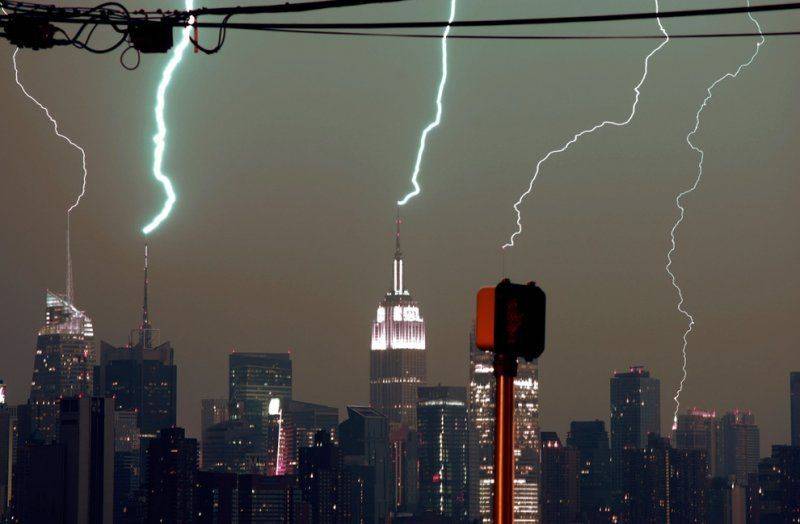

The whole idea of the lightning rod is that the lightning bolt will strike the rod rather than the object below it which the rod is mounted to
... building, mast with radio antennas on it etc. for the most part ( 99% of the time) it works
some types of metal masts will form part of the lightning conductor others don't and have lightning rods protruding from the top of them
this one below, you can see that the main strike occurred down from the top
one of those 1% of times that the lightning bold didn't go for the highest part of the structure
if you look closely, you will see a leader coming up from the top of the monument but it doesn't
connect to make the main discharge channel
I trust the first photo will show you that your source B is very wrongregards
