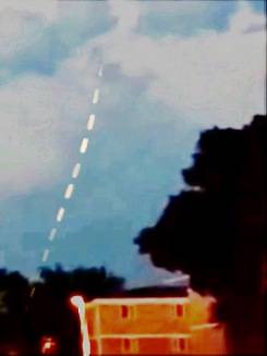

Hi,
Some time ago I was looking for lightning ball videos on youtube.
I observed some strange phenomenon recorded on one of the videos.
Before a lightning ball is created, some "dark" ball is coming from above
and then it immediately changes to the lightning ball which is moving at different angle.
It is well visible when watched in full screen mode, on 35 sec.
What do you think about it?
Is this recording real?
Many thanks!

Did you notice how it passes in front of the trees? That thing does not emerge from the clouds, which are much further away.

I'm not convinced that the ball/streak is in front of the trees. It passes close to the gap in the canopy so the foliage should be less dense. We are seeing a dark area of tree branch but that does not mean 100% leaf coverage. Some light will pass though leaves. I have walked in forests where I could not see any sky but it still looks like daylight. At 0:14 seconds to 0:15 seconds there is what could be a distant streetlight that comes into view. That could be an example of a small gap in the dense part of the trees rather than a light turning on and off.
It is hard for me to find the right frame on youtube but the "ball" passes the trees during 0:37 seconds. In one of the frames the ball has a much greener tint on my computer. Looks a bit like a white pixel next to a greener pixel. I am going with a white light passing behind leaves but bright enough to shine through. The leaves adsorb red and blue leaving [pun, haha] more green light to hit the CCD. On the otherhand it also has a more yellow/amber look at high altitude when the ball/streak appears and then turns bright white.
To be honest, even taking that into account the probability of being a bug is much higher than it being a ball lightning.
Likes Telemachus and russ_watters
Well, it travels on a smooth curve and at a constant rate. Not many insects I know of do that.
Don't attach much significance to relative brightness other than the top and bottom streaks. This is a composite of 12 successive video frames with transparency manually adjusted for overall visibility. Then the dynamic range was stretched to bring the contrast up to a useable level. The alignment point was the light at the top left of the building. If you zoom in there are a few JPG artifacts in the trees that don't exist in the original image, ignore them.

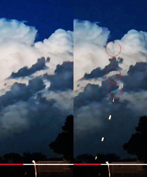

Ordinary explanation. I captured a loop of the video from some frames before the object appeared to a few frames afterwards. Go all the way to the top of the clouds above the yellowish building, to that sort of slanted 'V' in the top of the clouds. On the right (more horizontal) leg of the 'V' there's a small notch in the clouds, about 1/4 of the way up from the point of the 'v'
If you look, there's a dark streak that appears to be an insect moving downwards just before the light streak appears, and in pretty much the same direction and velocity.
My internet connection is currently too crappy to post an annotated pic or the video, I can post it tomorrow if anyone needs it but for now just loop over the section from about 7 or 8 frames before the light appears
Combined with the fact that there is no reaction from the guy filming, it seems like it could be just glare off an insect flying into a beam of light. The light seems too pure white and to switch on far too fast to be a firefly. The light of the ball does not illuminate the clouds it appears to come from. External illumination would explain an object rapidly going from dark to full brightness.
It's just a bug.
