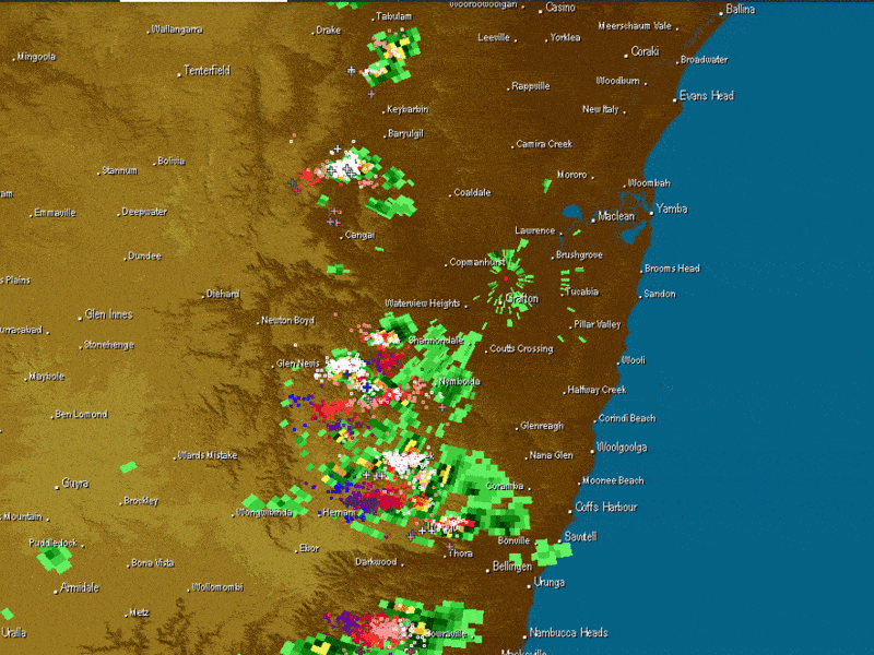

and just to show an example of that ... from one of the radars and lightning trackers, here in eastern Australia, yesterday
just radar ... the yellows, reds and purples are the cores with yellow the least intense and purple the most intense
below with a lightning overlay
note the white lightning strikes ( the most recent ones) occur around the cores of the various cells
(the blue, red and purple lightning strikes are the older ones )

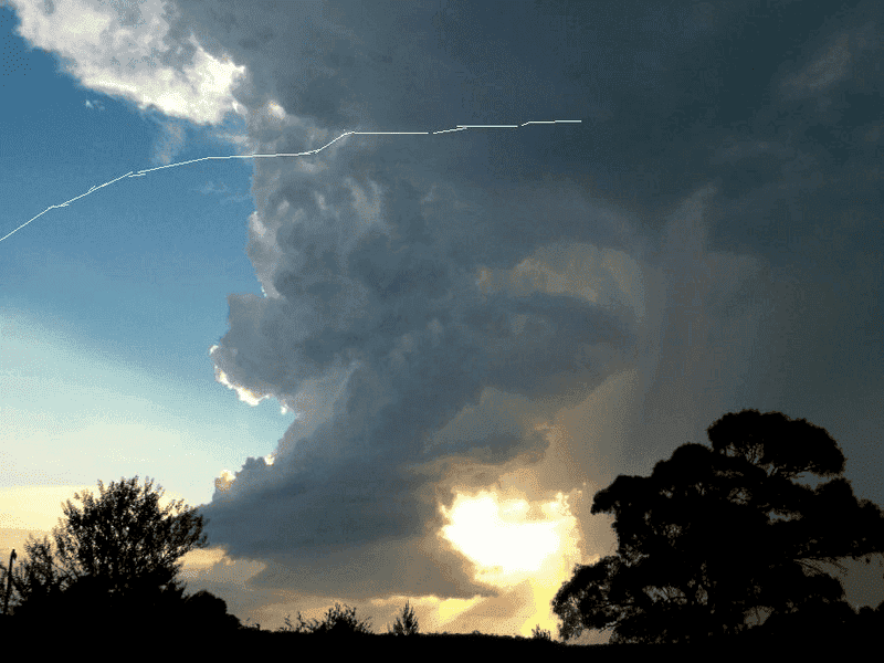

clear air strikes are not uncommon. A lot of people don't know that and think because the storm has passed they are safe. MOST of the time they are. But from time to time clear air strikes occur. I have seen the occasional one travel a number of kms out of a storm cell and down to the ground
This storm produced one of those ... I didn't capture the bolt on video unfortunately but have drawn on the pic the strike
It continues a bit further off the left side of the image before hitting the ground
