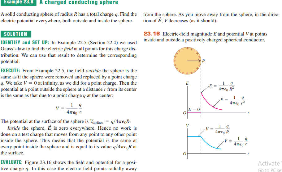

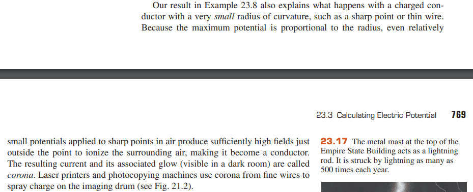

1) Q: Why does lightning strike high and sharp targets like a lightning rod?
A: Assuming that there is a massive collection of charge, possibly in clouds of a thunderstorm, trying to get to the ground where there is a pool of the opposite charge through an insulator that is air. I believe this is impossible until the accumulated charge in the clouds grow large enough to produce a electric field that overpower the dielectric strength of air and when it does, the necessary condition for a lightning bolt to occur is met. The preferred being installed at the top of the building feature of a lightning rod is actually there to shorten the distance between "heaven" and Earth, same reason why lightning prefers to strike trees. As for the sharp feature, in the embedded material I have included a very detailed explanation as to why sharp objects "charged" to a smaller potential would still efficiently produce a strong electric field as would larger objects, thus facilitating an "environment" through which accumulated charges in the clouds can easily move down on the rod then to the Earth. This along with the aforementioned reason why lightning tends to strike down on tall objects are my answers to this question.

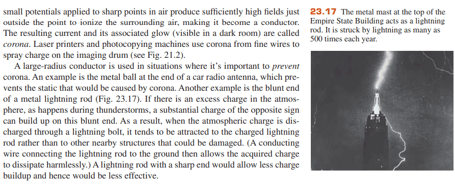

2) Q: As written in the material, to prevent Corona Discharge the OTHER end of the LIGHTNING ROD is preferably BLUNT. Why? By OTHER end, is the other end conventionally sharp? (silly question but I don't trust my own answer so...)
A: So as to store up more charges without breaking the dielectric strength of air, yeah maybe idk bruh...

The other end is buried in the Earth or any other handy high capacity conductor, so I do not understand the question .
Well in the pictures taken from my book that I posted along with this thread, it says that: "A large-radius conductor is used in situations where it’s important to prevent corona. An example is the blunt end of a metal lightning rod. A lightning rod with a sharp end would allow less charge buildup and hence would be less effective." But we always see sharp spearhead lightning rods pointing up towards the sky in real life so where is the blunt end? And according to my video I don't think we necessarily bury one end into the ground, we do ground it though by means of maybe a cable a a large copper stick...?

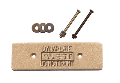

Boats with non-metallic hulls, need to settle for less. This dnyaplate is a commonly used way to ground the lightning rod in a boat.

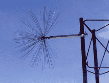

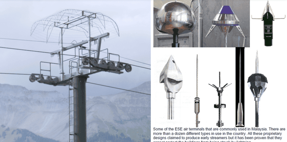

Devices like the one below are called charge dissipators. Their usefulness is similarly disputed and controversial.
It seems likely that none of these controversies will be settled in our lifetimes.
Likes Stephen Bulking and Lnewqban
anorlunda said:
... Devices like the one below are called charge dissipators. Their usefulness is similarly disputed and controversial.
Very interesting, anorlunda!
That picture reminds me of airplanes having “static discharge wicks”, which work based on a similar principle.
I would have thought that the usual sacrificial anode, made of Zinc and used to reduce electrolytic action on propellors and drive shafts, would achieve the same thing as long as the lightning rod is connected as well as the rest of the electrics and metal bits.
