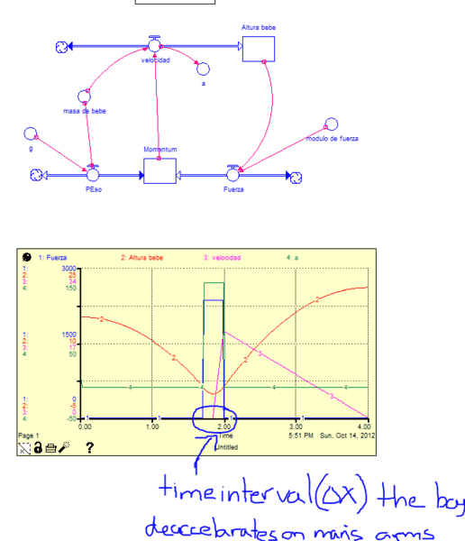

here is a STELLA simulations of the problem its in spanish, I am sorry but i think ull be able to understand "Altura de bebe" means the position of baby. Check them out and let me know if you see anything wrong with them.

If I scale and interpret that graph correctly, it appears to indicate that la fuerza agrees with your (and Pkruse) original answer, but I don't know why. Could be a book error??
