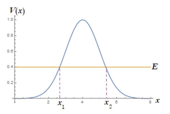

OK. This was probably discussed for the case where the particle tunnels from left to right through the barrier. That is, ##x_1## is the turning point on the left side and ##x_2## is the turning point on the right side. So, ##x_2 > x_1##.
The same formula (with no change in the integration limits for ##\gamma##) is valid in the WKB approximation if the particle tunnels from right to left through the barrier. The textbook appears to have made the mistake of assuming that the limits of integration should be switched in this case. You shouldn't switch the limits.
For example, suppose the potential barrier is symmetrically shaped, as shown.
Clearly, the transmission coefficient ##T## for right-to-left tunneling is the same as for left-to-right tunneling. In both cases, the turning point on the left (##x_1##) should be the lower limit of integration in the expression for ##\gamma##. Switching the limits would change ##T##.
