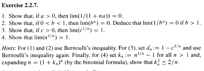

I need help with a part of Exercise 2.2.7 Part (1) ... ...
Exercise 2.2.7 Part (1) reads as follows:
I have managed a solution to this exercise and am posting it because
(1) I am unsure that the proof is valid/correct ... particularly given my arithmetic on ##\epsilon## ...
(2) I did not use Sohrab's hint ... and that concerns me ... but I am also interested in how Bernoulli's Inequality is used in this proof ... I can see how to simply involve Bernoulli's Inequality, but not how to use it profitably ...

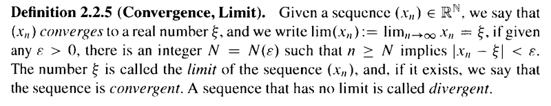

2. Homework Equations
The concepts of convergence of a sequence and the limit of a sequence are relevant ... so I am posting Sohrab's text corresponding to these notions ...

Can someone please indicate how Bernoulli's Inequality is used in a proof ...

This step is not justified. Consider ##\epsilon=\frac58, n=1, a=1, n=1##. The first inequality is satisfied but not the second.
I can't see any use for Bernoulli's inequality, but perhaps the author has in mind a different version of it from the one on wikipedia.
For (1) I'd be inclined to try using Corollary 2.1.32(a) with ##\frac1\epsilon## for ##x## and ##a## for ##y##.
