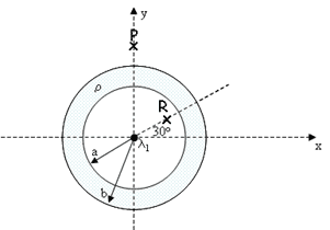

1. Homework Statement
An infinite line of charge with linear density λ1 = 6.8 μC/m is positioned along the axis of a thick insulating shell of inner radius a = 2.5 cm and outer radius b = 4.8 cm. The insulating shell is uniformly charged with a volume density of ρ = -667 μC/m3.
1) What is λ2, the linear charge density of the insulating shell?
-3.518247622μC/m
2) What is Ex(P), the value of the x-component of the electric field at point P, located a distance 8.1 cm along the y-axis from the line of charge?
0 N/C
3) What is Ey(P), the value of the y-component of the electric field at point P, located a distance 8.1 cm along the y-axis from the line of charge?
This is where I'm stuck.

Ey(P) = 2*k(this is 9.0E9)*(Charge density of outer shell * area of outer cylinder + lambda of line) all divided by radius (.081m) let me know if this works out for you

what you are trying to do in this problem is act like the system is a point charge so take the lambda you found in the beginning and add it to the lambda given multiply it by two and k and then divide by the radius (0.081)
Ok so (((6.8x10^-6)+(-3.518x10^-6))2(8,99x10^9))/.081
=728522.9629
Got it. Thank you so much! I think I'll have to work out that integral backwards.
