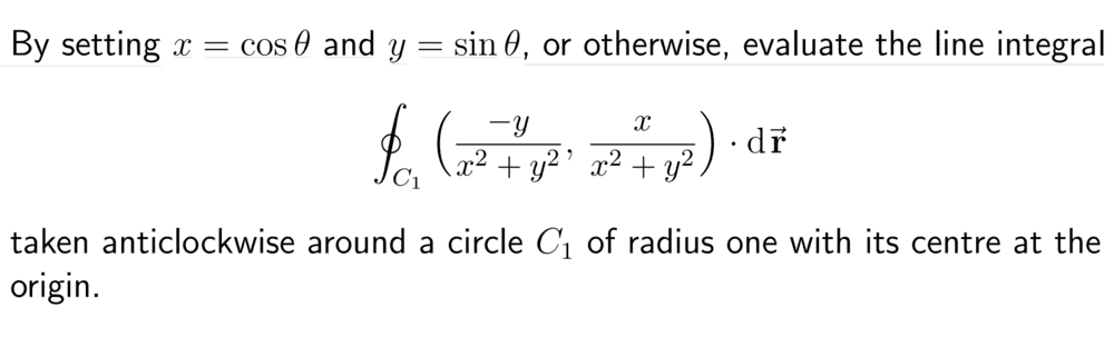

The picture below shows the text
Line integral

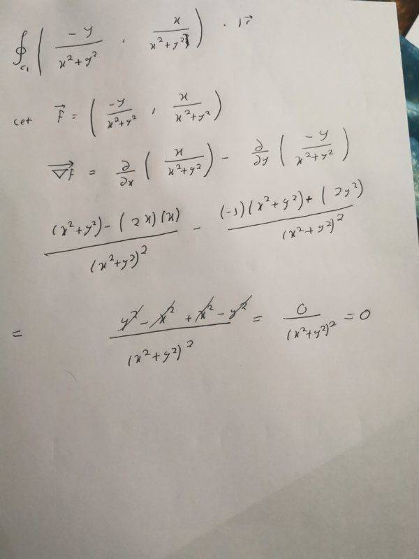

Hi everyone, I am confused in this question. First I solved it by noticing that the gradient of the function will be zero (without substitution the hit) I got that it's a conservative field so the integral should be zero since it's closed path. Then I solved it by the hit and convert it as any line integral like any normal integral in terms of the parameter which is theta in this case and evaluate it from zero to 2pi. I got an answer of 2pi. Which method is correct and why.

What gradient? You do not only have one function.
Please show your work and do not only describe it in words.
Please type out your work. Posting pictures makes it much harder to help you as they are more difficult to read and cannot be quoted selectively.
For what region is your computation of the divergence (note: not the gradient! Gradients act on scalar fields and yield a vector, divergence acts on a vector field and returns a scslar) valid?

The OP calculated the curl, not the divergence, but the same question applies.

You are wrong in thinking that a one form, i.e. something like f(x,y)dx + g(x,y)dy), or equivalently a vector field with entries (f,g), must have integral zero around every closed curve whenever d of it is zero, i.e. whenever ∂g/∂x - ∂f/∂y = 0. what is true is that if there is another function h such that f = ∂h/∂x and g = ∂h/∂y, then the integral is zero around every closed curve. This condition implies, but is not implied by, the weaker condition that ∂g/∂x = ∂f/∂y.
However there is a circumstance under which the two conditions are equivalent, namely they are equivalent in any region which, whenever it contains a closed curve, it also contains all points inside that closed curve. (As Orodruin suggested, the proof is to apply Green's theorem in that case). In your example, the functions f and g have denominator x^2+y^2, which means the region in which they are smooth does not contain the origin (0,0). Hence even though ∂f/∂y = ∂g/∂x, there is no guarantee the integral will equal zero around a closed curve that has (0,0) in its interior. Indeed getting a non zero result for the integral of your vector field around a given closed curve thus proves that the origin is inside that closed curve, so you have proved that the origin is inside the closed curve you integrated over.
