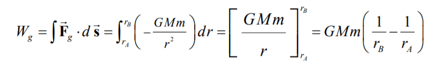

My problem lies in understanding how the following line integral, which represents work done by the gravitational force, was calculated
244166
Specifically, in the integral after the 2nd = sign, they implicitly used [tex] \hat{r}\cdot d\vec{s} = dr[/tex]
I wish to understand what is the argumentation for that.

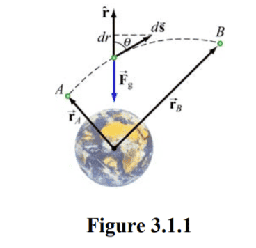

Following is the picture that ought to provide the argumentation (but doesn't do it for me).
244167
Gravitational force is ##\vec{F}=-\frac{GMm}{r^2}\hat{r}##. So the integral is $$-GMm\int_{r_A}^{r_B} \frac{\hat{r}\cdot \text{d}\vec{s}}{r^2}$$. Now, you can think of ##\text{d}\vec{s}## as a very little change in position, since it's a vector you can write it in spherical coordinates: ##\text{d}r\hat{r}+r\text{d}\theta \hat{\theta}+r\sin{\theta}\text{d}\phi\hat{\phi}##. When you do the scalar product $$\hat{r}\cdot \text{d}\vec{s}=\text{d}r$$.
Of course, this is not completely rigorous, you should parametrize the integral to reduce it to a Riemann integral, but at the end, this is a not completely wrong way to visualise it.

Thank you! I appreciate your answer :)

Static gravity is an example of a conservative vector field. The result of a path integral in a conservative field is independent of the path and is dependent only on the end points.
So use a path that swings from A over to a point at distance ##|\vec{r_a}|## along ##\vec{r_S}## (the integral over that part of the path is obviously zero since the path is always at right angles to the force) and then follows a path on out to B (that part is the simple scalar integral).
