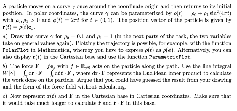

Hi,
I am not sure if I have solved task b correctly
According to the task, ##\textbf{F}=f \vec{e}_{\rho}## which in Cartesian coordinates is ##\textbf{F}=f \vec{e}_{\rho}= \left(\begin{array}{c} \cos(\phi) \\ \sin(\phi) \end{array}\right)## since ##f \in \mathbb{R}_{\neq 0}## is constant, ##\textbf{F}## would simply be ##f## in polar coordinates, wouldn't it?
##\dot{r}(t)## would be ##\dot{\rho}(t)## and therefore ##\dot{\rho}(t)=8 \pi \sin(4 \pi t) cos(4 \pi t)##
The line integral is:
##\int_{0}^{1} dt f \cdot 8 \pi \sin(4 \pi t) cos(4 \pi t)=0##
Did you leave out a factor of ##f## in the expression on the far right?
For Cartesian coordinates, I would express the force in the form ##\textbf{F}=(...) \textbf e_x + (...) \textbf e_y##.
For part (b) you are staying in polar coordinates.
##\textbf F## is a vector while ##f## is a scalar. So, they can't be equal. In polar coordinates, you would express the force in the form ##\textbf{F}=(...) \textbf e_{\rho} + (...) \textbf e_{\phi}##.
I think your line integral expression is correct.
However, it might be good to show your instructor how the integrand ##\dot{\mathbf r} \cdot \mathbf F## reduces to your expression. Thus, how would you write the vector ##\dot{\mathbf r}## in polar coordinate form ##(...) \textbf e_{\rho} + (...) \textbf e_{\phi}##? Then you can take the dot product ##\dot{\mathbf r} \cdot \mathbf F##.
In part (a) you considered the case where ##\rho_0 = 0.1## and ##\rho_1 = 1##. But it said to let ##\rho_0## and ##\rho_1## take on general values again in parts (b) and (c).

You're right, unfortunately, I had forgotten the f on the right-hand side of the equation.
In Cartesian coordinates, ##\textbf{F}## would then be ##\textbf{F}=f \cos(\phi) \textbf{e}_x + f \sin(\phi) \textbf{e}_y ##
##\textbf{Task b}##
##\dot{\textbf{r}}## would have to be derived using the chain rule, so it would look like this
##\dot{\textbf{r} }= \dot{\rho}(t) \textbf{e}_{\rho} + \rho(t) \dot{\phi}(t) \textbf{e}_{\phi}##
I'm still a little unsure about ##\textbf{F}##, would this be as follows?
##\textbf{F}=f \textbf{e}_{\rho} + 0 \textbf{e}_{\phi}##
Then, the scalar product of ##\dot{\textbf{r}} \cdot \textbf{F}=f \dot{\rho}(t)## since ## \textbf{e}_{\rho}## and ## \textbf{e}_{\phi}## are orthogonal to each other.
Is that correct?
That all looks very good to me.
Thank you TSny once again for your help and explanation, which helped me a lot 👍👍
