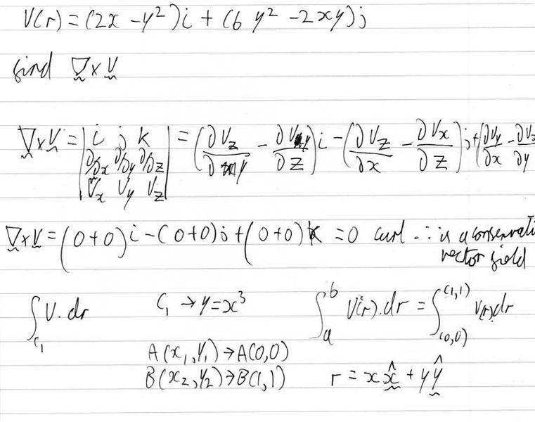

I could do part a ok, but part b has me stumped, I am in the second year of a physics degree and this is a from a maths problem sheet, i haven't done line integrals before now and they have me a bit confused, my textbook has a few examples but none of them include vectors and http://en.wikipedia.org/wiki/Line_integral" has me even more confused.
Here is my attempt so far:
(please excuse bad handwriting, i am dyslexic)
I basically don't know where to begin with it, any help much appreciated.
Use that along your path y=x^3. So r=x*i+x^3*j. (i=x hat and j=y hat). What is the vector dr? Change the y's in V to x^3's as well and integrate dx.
I think dr is just a small difference in the postion vector r, so dr = dx*i+dy*j ? r isn't mentioned anywhere else in the question.

Sure it is. But now let's decide to integrate dx. Replace y with x^3. Now what's dr?
dr=x*i +(x^3)j
I also have V(r)=(2x-x^6)i + [(6x^6)-(2x^4)]j
But i am a bit unsure about V.dr, is it {[ (2x^2)-(x^7) ]i + [ (6x^9)-(2x^7) ]j}dx ?
What happened to the 'd's on the right side of dr? You've got y*j, shouldn't it be d(y)*j? Same for i. Let's get dr right before going to the dot product.
OK, i jumped the gun a bit with dr, is it d(r) = d(x)*i + d(y)*j = d(x)*i + d(x^3)*j ?
Right. And d(x^3)=3*x^2*dx, right? So dr=(i+3x^2*j)dx.Now do the dot product and you'll get a single integral dx.
Ok, V.dr=[(2x-x^6)+(18x^8)-(6x^6)]dx
When i integrate this with the limits x1=0 and x2=1 i get 2, does this sound about right?

That's what I got. Not so hard, hmm?
