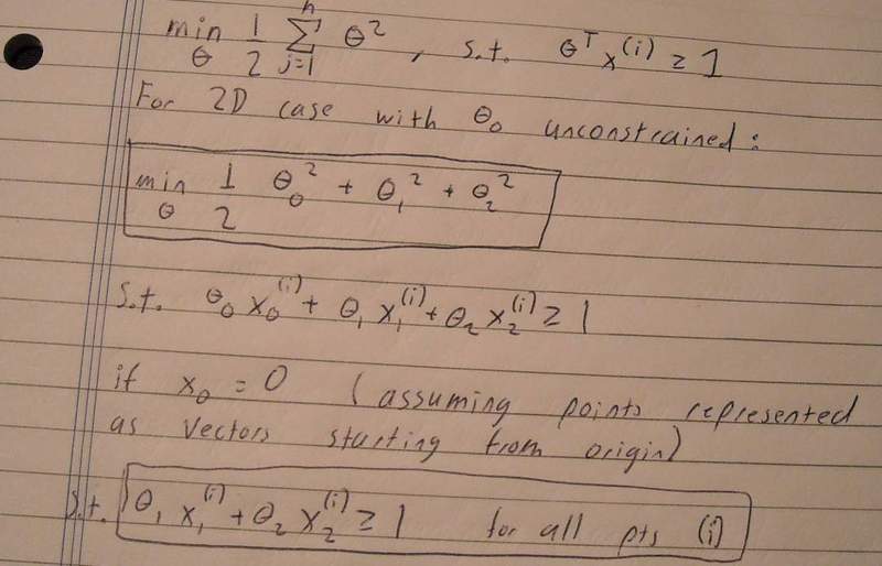

Say I have a set of points in 2D space. How would I find a line that maximizes the sum orthogonal projection of the points onto the line. The line does not have to go through the origin.

Sorry, I did not formulate my question properly. I'll describe the application. Say that I have a set of points as shown in the photo. Some points are red and some are green. I want to find the line that separates the two groups with as much margin as possible. Support vector machines do this, but I want to know how the black line is selected. If the groups cannot be perfectly separated, then I want to select the line that separates the groups as best as possible.
This youtube video here:
http://www.youtube.com/watch?v=-Cn5...iHIyxJq0hw_9b8w2j_sWOVe&feature=results_video
At 17:00 shows the formula for how SVMs select the decision boundary, but it assumes that the decision boundary goes through the origin.

@googleadbot: The video gives a formula for the quality of the separation. You can parameterize your line and express the quality as function of those two parameters. Then you have to minimize/maximize it: Find points where both derivatives (in the line parameters) are 0.

Hi mfb, I think you're right about taking the derivative on the minimization function. However, that's where I'm stuck. The minimization function has 3 parameters for 2D space: theta0, theta1, and theta2, no? How do I take the derivative of a funtion with 3 variables?

I think I can see how I can parameterize my line, but what matters, according to the video, is the vector theta that is normal to the line. Doesn't the line have an infinite number of normal vectors corresponding to it? If I want to parameterize the normal vector theta, then I would need at least 4 parameters as far as I can tell, because the vector would require both direction as well as magnitude (2 parameters) as well as the origin of theta (x/y coordinates of the base point). With that many parameters, I don't see how I can find a direct solution...I think this problem might require quadratic programming (that's what SVM uses to find the boundary line), problem is that I'm not sure how it does it and code to SVM Light or SVM Lib is pretty hard to follow.

There is an infinite number of normal lines, but just one which passes through a specific point.If you express your line as ##px+qy=c## where ##p^2+q^2=1##, that is equivalent to ##\vec{x} \cdot \left( \begin{array}{}p \\ q\end{array} \right) - c= 0## for points p on the line. The nice feature of that expression: it allows to calculate the distance in a very similar way: $$d(\vec{x}) = \vec{x} \cdot \left( \begin{array}{c}p \\ q\end{array} \right) - c = \vec{x} \cdot \left( \begin{array}{c}p \\ \pm \sqrt{1-p^2}\end{array} \right) - c$$
You can add the distances (or the absolute value of those distances) of all points and find p,c where that sum is minimal.
