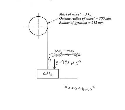

I have this picture from the question:
I understand how the acceleration of the mass due to gravity acts upon the 0.5kg mass and causes the F = m g to act upon the rope, however its the subtraction of the mass times the acceleration I do not understand, I thought if anything that would also be causing tension on the rope rather than negating it as the acceleration is in the same x direction!
I'm sure there is something glaringly obvious I am missing!
Edit: I am not sure if it is to do with the mass of the flywheel oposing the freefall of the object perhaps?

THE free body diagram I am waiting for (:smile:) shows two forces acting on the 0.5 kg mass: the force of gravity and the tension in the rope.
The equation of motion for this mass is simply ##F_{\rm net} = ma ##

Ohh!
Gravity is acting on the mass pulling it downwards, however as we calculated it is only accelerating at 0.44 m s ^-2 not 9.81 m s ^-2 therefore the rope is subject to the tensional force of the difference between the two once plugged into the second law?
I have drawn a FBD (which is how I arrived at this conclusion) Not sure if it's quite right but it worked (assuming I am on the right track!)
Thank-you so much for the help so far (again assuming I am thinking along the right lines) it seems very obvious now!

If the rope weren't there, the acceleration would be ##g## indeed, so the tension in the rope must be responsible for the difference.
As you see from writing out ##\ F_{\rm net} = ma \ ## : $$T - mg = ma $$ (up = positive, ##g## = 9.81 m/s2) leading to ##a = -9.81 ## m/s2 when T = 0 (as 'desired') and to ##a = - 0.444## m/s2 with the value of T the exercise wants as answer to c).
