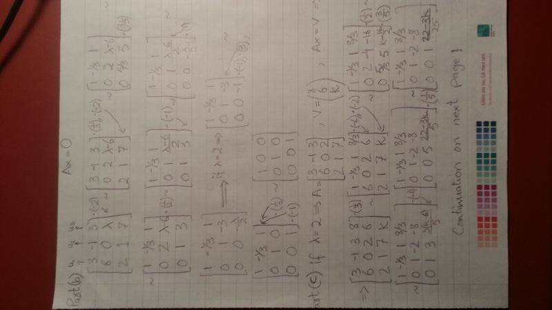

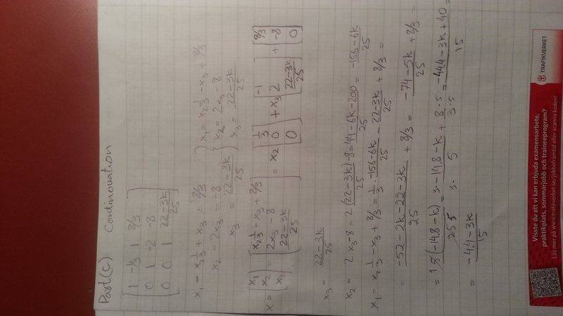

For part (a) I calculated the determinant just like you did. I got D=60-5λ then I put 60-5λ=0 => λ=12.
Then I substituted lambda for 12 and calculated the determinant again and got D= -6
I recalculated part (b) and (c). I took pictures of the calculations and uploaded them here.
In part (b) I got/chose λ=2 and in part (c) I could not find an answer for K.
Do you not notice the contradiction? If the determinant is zero when λ=12, how can be the determinant -6 if λ=12?
You made a mistake in the Gauss elimination at the end of the second line, first page.
If the determinant is zero, the equation Ax=0 has non-trivial solutions, that is, linear combination of the column vectors of the matrix can be zero. Are the column vectors independent or dependent then?
ehild
