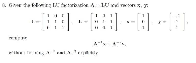

Linear algebra -- compute the following without finding invA
In summary: The question says to find "an easier way to do this". A quicker way to find the inverse of a matrix may not be what they had in mind.

A=LU, U^-1 * L^-1= A^-1 , U^-1 * L^-1 * U^-1 * L^-1 = A^-2,
I used MATLAB and the relations:
to find a solution
I found U^-1*L^-1 , let =B
Then, found B^2 and took the inverse of B to get A^-2.
B=A^-1
C=inv(B^2)
so we have B*x+C*y= [2;5;10]
My question is: is there an easier way to do this? We are supposed to do this problem by hand. This would have taken a good amount fo effort to find so many inverse matrices. Any input is appreciated!

L and U are triangular matrices, so I don't think it would have been all that hard to compute their inverses by hand, especially since they're only 3 x 3. Also, once you have A-1, just multiply it by itself to get (A-1)2. You don't have to do the product of four matrices you show.

When you found matrices, B and C, that violated your instruction which was that you should not form A-1 and A-2 explicitly.
Simply find L-1 and U-1 and use those. They are easy to find by hand.
As you say, since A= LU, [itex]A^{-1}= L^{-1}U^{-1}[/itex] and [itex]A^{-2}= L^{-1}U^{-1}L^{-1}U^{-1}[/itex] so the first thing I would do is find [itex]L^{-1}[/itex] and [itex]U^{-1}[/itex]. Since L and U are triangular, that should be easy to do "by hand".

You can do it by solving equations with ##A## on the left, which is doable easily from the LU decomposition. You want to compute ##v+w##, where ##v = A^{-1} x## and ##w = A^{-2} y##. We can get ##v## as the solution of the system ##A v = x## and we can get ##w## as the solution of ##A^2 w = y##, and this, in turn, can be obtained from the systems ##A w_0 = y##, ##A w = w_0##.
I don't know if this is what the questioner really wants.
