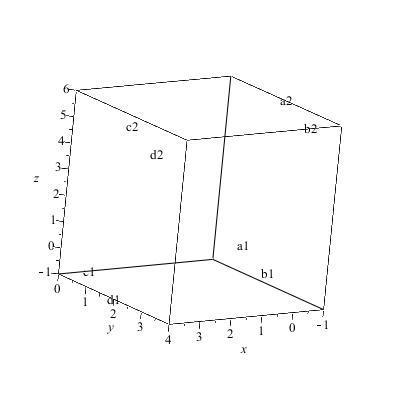

If you have access to Maple, you can use the "textplot3d" command. If your eight points are a1,b1,c1,d1,a2,b2,c2,d2 , where the first four have the four smallest z-values and the last four have the four largest z-values (but with the points otherwise being in the order you listed them), here is what you would get:
You can choose any point as a corner of the parallelepiped. Then determine all vectors pointing to the vertices from that corners. You need three independent vectors from them, to calculate the volume.
The volume is equal to the magnitude of the determinant which columns (or rows) consist of the three independent vectors spreading out the parallelepiped.
