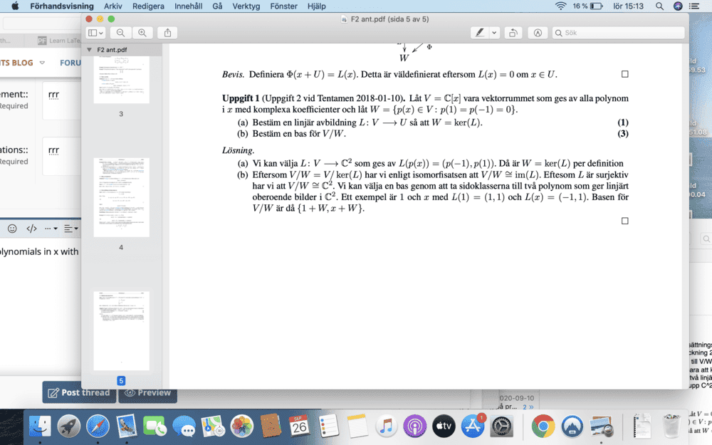

Let V = C[x] be the vector space of all polynomials in x with complex coefficients and let ##W = \{p(x) ∈ V: p (1) = p (−1) = 0\}##.
Determine a basis for V/W
V = C[x]

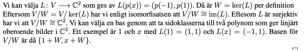

The solution of this problem that i found did the following:
Why do they choose the basis to be {1+W, x + W} at the end? I mean since
##dim(ker(L)) + dim (im(L)) = dim(V), dim(ker(L)) = dim(W)## and then ##dim(im(L))=2 = dim(V) - dim(W)## that means ##dim(W) \rightarrow \infty## because there is an infinite number of linearly independent polynomials that satisfy p(1)=p(-1)=0. Can't I just choose W to be a basis for V/W?
Thanks in advance!

I think there's some confusion. W in the vector space V/W is a single vector, and is the zero vector. Recall V/W is the space of sets of the form x+W for some x, where is x-y is in W then x+W = y + W.
This is what they mean when they write 1+W and x+W.
If you really want the whole set W to be your sweet of basis (which doesn't even work, since they don't even span the space in question) you would have many linearly dependent vectors and you wouldn't have a basis.
As you observed some of the vector spaces have infinite dimensions, so your formula for the dimension of the image and kernel don't actually make sense. I can't read what is written in the solution but it looks like they take a different approach to show V/W has 2 dimensions
##p(1)=0## means ##(x-1)\,|\,p(x)## and ##p(-1)=0## gives ##(x+1)\,|\,p(x)##, so we have ##(x^2-1)\,|\,p(x)##. Now ##V/W = \mathbb{C}[x]/(x^2-1)\cdot\mathbb{C}[x]##, which means we can reduce any polynomial ##p(x)## to one of degree at most ##1## by writing ##q(x)=f(x)\cdot (x^2-1)+ g(x)\, , \,\deg g \leq 1.## Thus we have ##\pi(p)=g## if ##\pi : V\longrightarrow V/W## is the canonical projection. Since ##g(x)## is of degree zero or one, we can use ##[ g]=1## and ##[g]=x## as representatives of the equivalence classes. You cannot use dimension formulas, as ##\infty## isn't a number.

Hi Office_Shredder! Thanks that is just the type of solution i was looking for :)
Hi fresh_42! Thanks for another great solution that was easy to follow!
