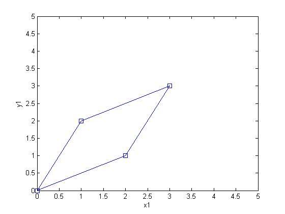

Here is the parallelogram supplied with the problem. The points are arbitrary, so I just made them x = 0, 1, 3, 2 and y = 0, 2, 3, 1:

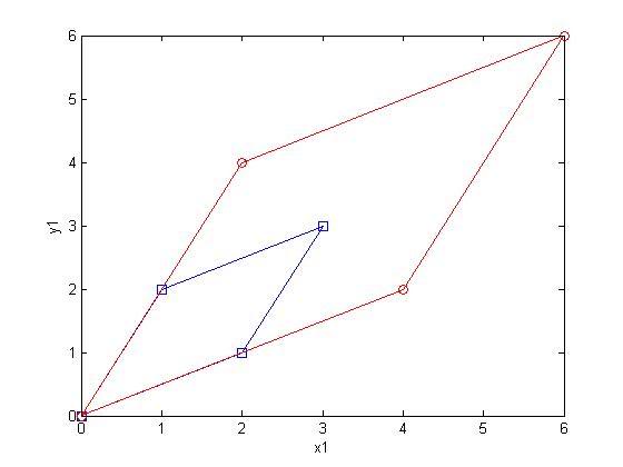

I am going to use the following scaling transformation on the parallelogram:
[tex]\mathbf{T}\,=\,\left[ \begin{array}{cc}
2 & 0 \\
0 & 2 \\
\end{array} \right][/tex]
Here is a picture of the transformation:
Would this picture count as a "sketch of the image"? What are they implying by "image" anyways? There is an Im(v) function in linear algebra as well, right? This all seems very confusing, how would I start a proof of the line segment thing?
