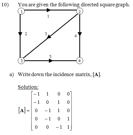

I am given the follow graph and asked to find the left null space
First I start by transpose A because I know that the left null space is the null space of the incidence matrix transposed. I then reduce it to reduce row echelon form and use the follow relations
R = [I F;0 0]
N = [-F I]^T
This provides me with the left null space being
y_n = [1 - 1 0 1 0]^T, [-1 1 -1 0 1]^T
below you'll find my work
apparently I did something wrong because the answer is
I don't see what I did wrong in my computation. I believe that perhaps my error is in the conceptual understanding and I am not interpreting something correctly and missing a process. Thanks for any help someone can provide

Is there some reason why your ##A## has row ↔ arc and column ↔ node? Almost any source I could cite would have it the other way, so your ##A## would be the transpose of the incidence matrix for almost everybody else.
That's weird that's what we were told were the rows are the edges and the columns are the nodes. It does make a difference if you do it the other way around. I've been doing it wrong?
I think for this one <1 -1 1 0 0>^T if you start at node 1 and go to node 2 you have <1 X X X X>^T and then go from node 2 to node 3 you have <X X 1 X X>^T and then you go from node 3 to node 1 (the opposite direction in the graph) you have <X -1 X X X>^T giving us <1 -1 1 0 0>^T which is the upper triangle loop. The other answer they give for the left null space is <0 0 1 -1 1>^T which is the closed loop around the bottom triangle. I just don't understand why is the closed loop around the upper and lower triangle considered the left null space of the graph?
