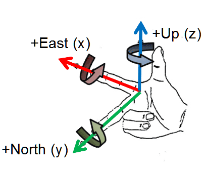

I should briefly talk about something else too, the right-hand-rule. Basically, this states that, while you're looking down any axis at the origin, counter-clockwise rotations are positive, and clockwise rotations are negative. It's easy to visualize this as a piece of graph paper. You don't often think about it, but you're looking down the Z-axis when you're looking at graph paper. Rotations around this Z-axis around the origin are positive if they're counter-clockwise, rotating toward Y+ off of the X+ axis, which typically shoots off to the right. If we extrapolate this to 3-axes (3D), this is the right-hand-rule. Here's an image I once made trying to illustrate this:
Okay, forging on. Again, we've defined a "basis" (origin, X+ direction, Y+ direction, and Z+ direction) for our room. However, in truth, we can define any basis we like, so long as it's got an origin, an X+ direction, a Y+ direction, and a Z+ direction. You could think of the origin as the point in the above figure where the red, green, and blue lines converge. And then the X+, Y+, and Z+ directions are three points anywhere along the red, green, and blue lines. (Ideally, these lines are exactly one unit long, but this isn't absolutely required.) Also, as another FYI, these three directions are required to be orthogonal.

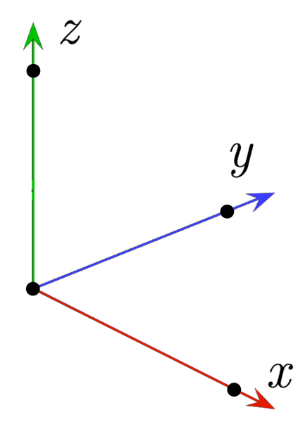

Let me see if I can pull together some figures to illustrate an example. Alright, the following figure represents a basis in 3D space:
We can represent this basis with four vectors (or points) (with each vector having an X, Y, & Z component). We'll call the vector where the lines converge the "origin". For simplicity, we can think of this as <0,0,0> but it doesn't necessarily have to be.
Next, we've got a vector for the point on axis X, a vector for the point on axis Y, and a vector for the point on axis Z. The combination of these four vectors makes up an ordered basis.
