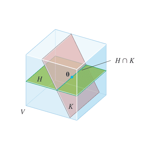

Let H and K be subspaces of a vector space V. The intersection of H and K is the set of v in V that belong to both H and K. Show that H ∩ K is a subspace of V. (See figure.) Give an example in ℝ2 to show that the union of two subspaces is not, in general, a subspace.

This is what I started off with:
Let u,v ∈ H; s, t ∈ K
0v ∈ H, K
u + v ∈ H
s + t ∈ K
In the middle of writing that down, I was thinking that v is a set of vectors in V, and that H ∩ K = Span{v}, therefore, per Theorem 1 in the book, H ∩ K is a subspace of V.
Written as:
v ∈ V
H ∩ K = Span{v}
∴ H ∩ K is a subspace of V per Theorem 1.

For the first part, you would need to show that ##H \cap K## is the span of v. That is easy to do using the definition of subspace. Since I don't have your textbook at hand, I don't know what Theorem 1 says. Perhaps it covers the missing pieces.
For the second part, your example does not work because m and n are not subspaces of ℝ2 as you have defined them. (Check the definition of subspace again.)

This isn't a good start, since you are already given that H and K are subspaces of V. So we know that both are closed under vector addition and scalar multiplication.
A better start would be to assume that u and v are arbitrary vectors in H ∩ K. Show that their sum is also in H ∩ K, and show that any scalar multiple of either one of them (say u) is also in H ∩ K.

Second stab:
H, K are subspaces in V
H ∩ K = {v} in V
To be a subspace of V, H ∩ K must comply with the following:
1. Contain the 0 vector:
0v ∈ H ∩ K b/c H, K are subspaces and therefore contain the 0v
2. Closed under vector addition:
Let u, v ∈ H ∩ K, then u, v ∈ H, K which means that u + v ∈ H, K which means that u + v ∈ H ∩ K
3. Closed under scalar multiplication:
Let c ∈ ℝ, u ∈ H ∩ K, then u ∈ H, K and cu ∈ H, K which means that cu ∈ H ∩ K
It took me a second b/c I don't think I really understood what was being asked. Once that clicked, the work became much easier.
