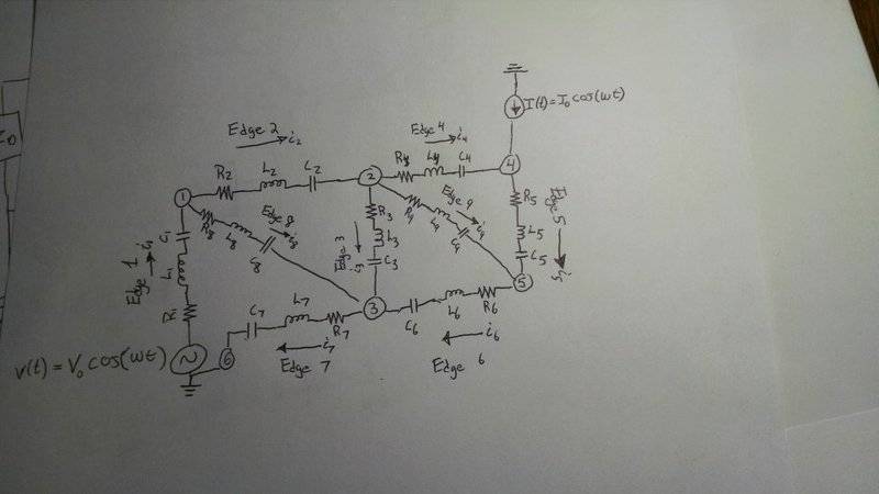

So yeah I'm doing a project were I get to create a problem. I would like to learn how to solve a AC RLC circuit using linear algebra. I'm trying to find all of the currents on the edges of the graphs and find all of the voltages at the nodes connecting the edges. I don't think I should really put this in the engineering forum because I seem to really be struggling with the linear algebra and mathematics behind it. I solved circuits like this before, but not with the linear algebra perspective. If you can provide any assistance or point me in the right direction that would help. I'm just using all symbols for now and will put in numerical values later.
This is my weighted graph

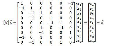

Alright so I start with finding the incidence matrix.

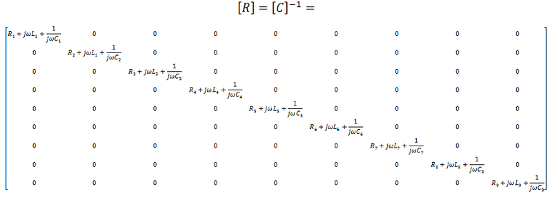

So then I find the impedance matrix

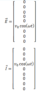

Then I find the voltage and current source vectors.

Does this look ok so far?

You say you are struggling with the linear algebra behind solving say a complicated electrical circuit.
Why did you develop such a monster problem if this is the case? This circuit is clearly too complex to solve by hand, which is why you plan to dump it into MATLAB.
Couldn't you find a simpler circuit to practice on, one which is DC rather than AC, and get your LA problems straightened out before you move on to something which is unlikely to be solved by hand?
Otherwise, dump your calculations into MATLAB and see what solutions you get. You can always check the results afterward and see if the solution obeys the various network laws.

Each branch would have something like
V = i*R + (1/C) integral i(t) dt + L*(d[i(t)]/dt)
How do I go about forming the resistance matrix of the resistance in each branch when it's DC? I guess I'm struggling with that. That's why I thought initially AC would be easier. In my book they show forming the resistance matrix with nothing but a resistive circuit. I have to make it a bit more complex because it can't be so similar to home work problems. I thought AC would be easier because than I could easily create the resistance matrix.

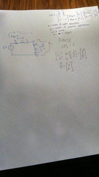

I guess my question is how exactly do I go about finding the resistance matrix of the graph if it's a DC RLC circuit. Like in my picture it would just be a DC voltage instead of V and a DC current source of I.

I was told that the incidence matrix has to be at least 6x6.
Why? Who told you this?

The incidence matrix is not that complicated to setup; it just depends on how many different connections are made at each circuit element.

Yeah I have solved circuits before using mesh analysis. It's easy. But how do I tie in linear algebra into this system by mesh analysis? I'm not exactly sure. I wouldn't know how to find the resistance matrix for an RLC circuit because I can't simply lump together the resistance of an RLC unless it was impedances that I could lump together in a AC case.,
I think mesh analysis provides me with the left null space of the linear system.
My professor said so =(
But how do I go about finding the Resistance matrix specifically?
See I try and solve a simpler problem but am unsure how to find the matrix R in a DC RLC circuit. In a purely resistive circuit the matrix R is simply a diagonal matrix with the resistances in a RLC circuit I'm unsure how to form R. In a AC case I would just lump the impedances. So I'm not sure how to find R specifically in a DC RLC circuit.
