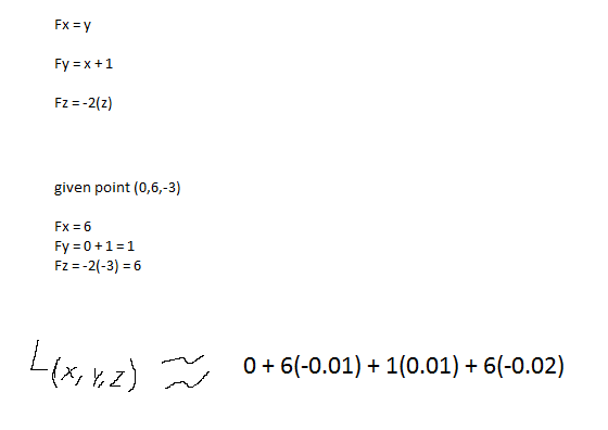

Find linear approximation of the surface z2 = xy + y + 3 at the point (0,6, -3) and use it to approximate f(-0.01, 6.01, -2.98)
[/B]
so this means the total surface has decrease by -0.17?
