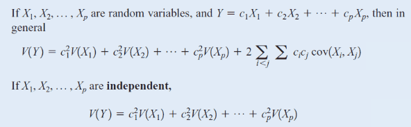

This is from the lecture slides:
I forgot to mention it, but the ##W_i## are identical and independent, so the double sum is null. My bad..
Then it's fine.
