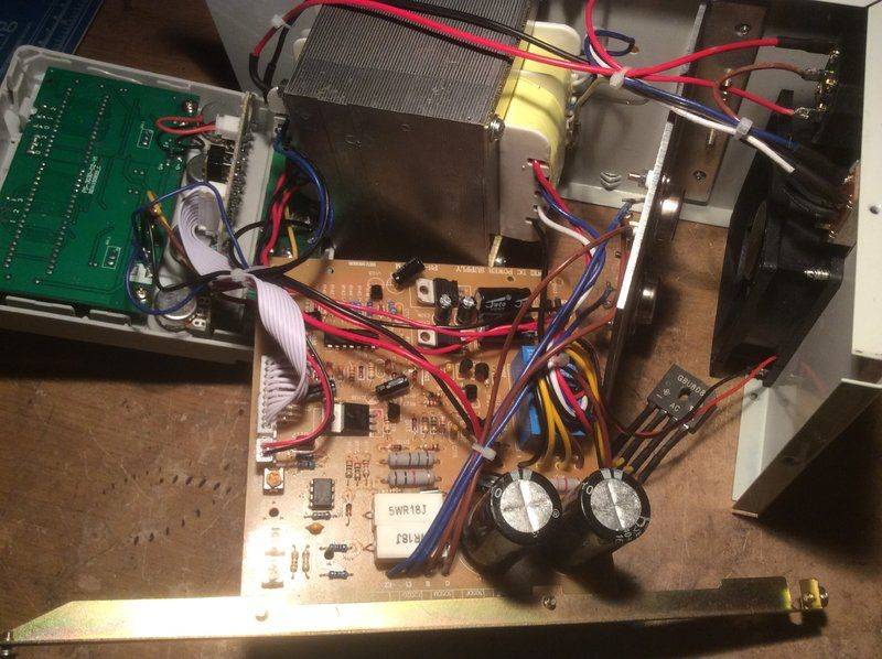

I was showing a young lad how you can energise a car ignition coil and get a spark on the output, and that this effect can be improved by adding a cap in parallel which forms a crude LC oscillator etc when the unit died. Silly, I know, but we got a bit carried away. At least he learned something.
The unit powers on, fan runs, but the display reads 0.00V and 0.00A (correct readings) and the current limit light is on.
I realize that troubleshooting a board remotely and from a picture is not feasible, but is there a general layout common to these units that might point me in the right direction?
The fault was most likely caused by a transient from the coil primary, or just simple, repeated overcurrent. This might point me to an IC, such as the LM324 at the top, or the 0P07CP precision op amp on the left. The voltage regulators are working (7815 and 7915).
The large caps are being charged to 20V, but that is not getting thorugh to the output as the series pass 3055s are 'off'.
Any help would be much appeciated.
Could be voltage sensing or current sensing or blown pass transistors or the supply to the current and/or voltage sensing stages. Time to draw a schematic, sorry.

Yes, I thought as much. It's only a cheap power supply but I like the fact it's linear and has that big transformer.
Since the CC light is on for no reason, perhaps I should follow the current sense circuit first? Those large 5W 0.18 ohm resistors are the current shunts - I imagine one of the four LM324 op amps is connected directly across these.
The pass transistors read OK on a simple diode check, and all ICs appear to have power and ground.

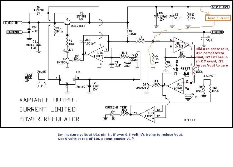

Jim - I can't see a crowbar circuit (looking for an SCR?) but there is a diode across the output. It's OK. There's only a few mV of ripple on the main caps so they're still doing their job.

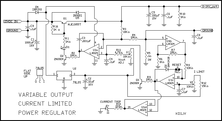

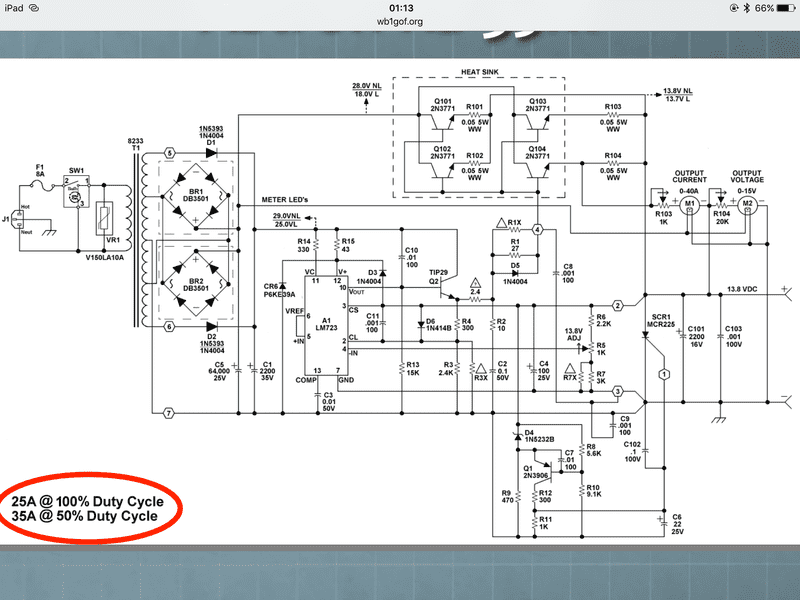

Tom - thanks for those videos. I also found...
The second one is the most similar, being based on the LM324.
Given that the LM324 is the 'brains' of the outfit, and the component most likely to suffer from my hi-jinks, I'll replace that and report back.
I hope you can find your schematic.
Maybe above will help you 'talk your way' through how it works.
Something worth suggesting is to power up the supply WITHOUT the op amp in circuit. Take some voltage measurements and see to that everything makes sense. You can even try driving the pass transistors through some current limiting resistors and a pot or even from another variable supply with a current limiting resistor.

Well, the power supply is up and running again:
1. I fed in some voltage from an AA battery and verified the display board was OK.
2. Piggy-backed a new LM324 on the old one and got a change in behaviour - CC light went out but still no output. I took this to be a sign I was on the right track.
3. Replaced LM324 and all was working again. I have an el cheapo desoldering gun so lack of socket not the end of the world.
