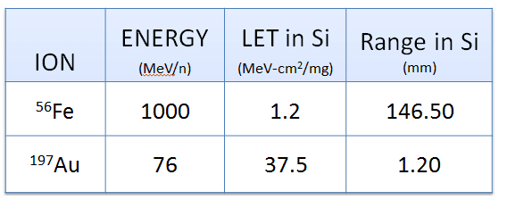

I am sorry, I had misspelled it. Yes, I was talking about Linear Energy Transfer. Please look at the table below that I have included.
I am not sure but I believe that "Range" is inversely proportional to the square of atomic number (Z^2), correct me if I am wrong please.
I understand that an ion with higher LET will have a shorter range, since it will give off more energy per unit of length. But the part that doesn't make much intuitive sense is when I start thinking about this in terms of classical physics 101 (e.g. momentum).
If we have two objects at the same speed, but one weighs more, then it will travel a longer distance. And this make intuitive sense, because it is heavier.
Now, isn't it that Au ion is heavier than Fe ion, so shouldn't we expect for Au to travel a longer distance?! Because to me Au has higher momentum.
This is the part that I get confused. I would appreciate if I get a clarification to my confusion.

What about the second column in your (?) table ? Is that MeV/nucleon ? Or per neutron ? Is there a reference for the table ?

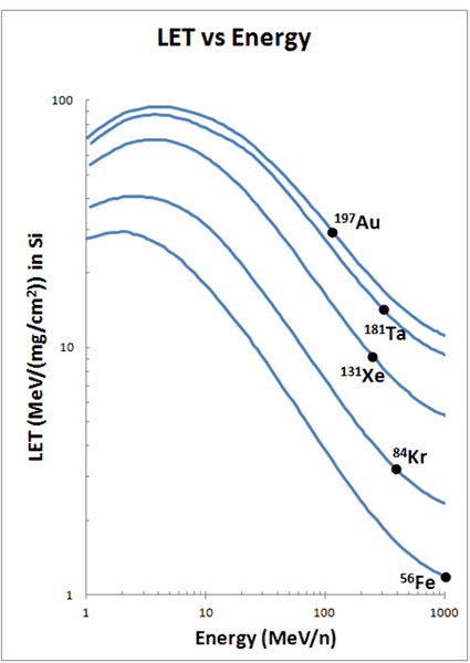

Look at this for example:
You can find a similar plot in almost any reference material. So, the general rule is that the heavier the ion, then its LET is higher...
So, I don't understand why this is the case?! Can you explain please?
Because as I said, to my understanding, I think that the heavier the ion is then the more momentum it has, therefore I am expecting for it to travel farther, before coming to stop, which would imply that it should have a lower LET...!
But I know this is not the case, and in reality it is the opposite... The heavier the ION, then higher the LET... Why?
