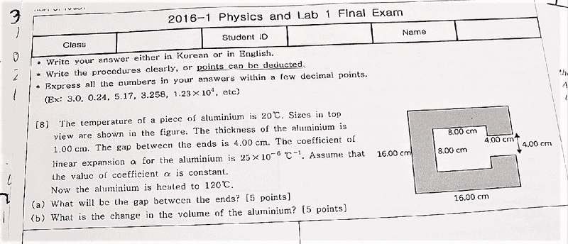

Linear expansion by heat for an object
In summary: The linked image is hardly any better. Why not take a closer shot instead of leaving all that whitespace?Much better. I concur with both answers.Much better. I concur with both answers.In summary, ehf states that a gap would shrink when heated.
ehf
http://i.imgur.com/swYr8aw.jpg
delta L=LalphadeltaT
sorry for s**ty handwriting look at #8[/B]
http://i.imgur.com/59Ew8vJ.jpg
edit:click the links please. The forum software cropped the quality of the photo.

I cannot read the problem statement. If I blow it up large enough to be read it is just a blur.
fixed problem
ehf said:
fixed problem
That's the best I can do with computer enhancement .
I could not do much with the other image .

The imgur link should be just fine. I can read it on all magnification. The server cropped the displaying image whatever i did
@ehf . We understand the question now .
This type of problem comes up frequently and once you understand one simple principle solving these problems becomes easy and usually requires little calculation .
Consider a square plate with a round hole in it - do you think that the hole gets larger or smaller in diameter when the plate is heated ?
smaller because of expansion @Nidum
ehf said:
smaller
I must be missing something.
My reading of the answer to a) at the link, messy as it is, is that the gap increases, which is correct.
@Nidum's post #8 implies that at some point in @ehf's posts it is stated that the gap will shrink, but I cannot find such.
In response to the direct question from Nidum, ehf says that a gap would shrink.
@Nidum, what made you suspect ehf would answer wrongly?
I was working towards explaining the basic physics of expansion . In particular that gaps expand in the same way as solid metal .
I was still having difficulty reading ehf's writing when I made that posting .
my fault...it doesn't shrink anywhere...only stretches
