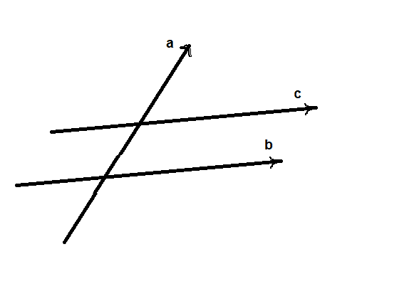

I drew the three vectors and have no idea what I am supposed to figure out from this.

Can you post the picture you drew?
It seems to me that three vectors like these are linearly independent
  • #31
Note that for three vectors linear independence is a test of all three vectors. It cannot be reduced to a test for each pair of vectors.
In your diagram, any of the three vectors can be expressed as a sum of the other two. So, they are linearly dependent. You can have at most two linearly independent vectors in ##\mathbb R^2##.
It's not a question of linear independence of any two vectors. It's a question of all three vectors taken together.
Likes Salmone
  • #32
Ok so in general the answer to my first question is no, if I have 3 or more vectors I can't check their linearly independence just looking at 2 vectors per time, I need to check the whole independence.
