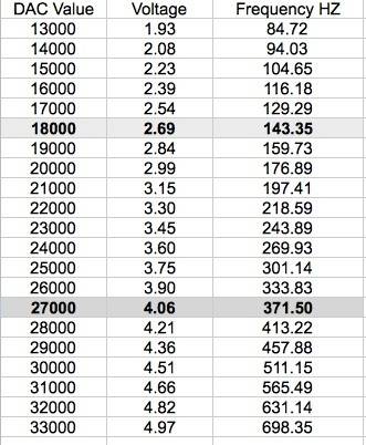

I'm trying to improve and speed up the calibration time by instead of increasing the voltage , send out a voltage via the DAC let's say DAC = 18000 = 2.69v and then take a frequency reading which on the attached example chart is 143.35 hz
Then do the same again let's say DAC = 27000 = 4.06v and then take a frequency reading which on the attached example chart is 371.50 hz
What i want to be able to do is have a equation that will calculate for example what value on the DAC is required to get a frequency reading of let's say 100 hz , using only the two sample values i have collected DAC = 18000 = 143.35hz and DAC = 27000 = 371.50hz. I know the frequency is logarithmic compared to the DAC value. And I know that for this synthesizer each 1000 increase in the DAC equates to a frequency rise of about 11.172 % , but for the life of me I have no idea or direction on how to work out the DAC value for a specified frequency, and I'm hoping some one might spare the time to point me in the right direction.

I got the Excel file. The output voltage appears pretty linear with DAC code, and the frequency is exponential with DAC code. So taking the log(Freq) gives a pretty linear relationship with the DAC code.
I'll try to spend a little time this afternoon figuring out the equation that relates the DAC code to the frequency -- it should be a pretty simple equation.
So the DAC output is pretty linear with a zero offset (the top graph in the attachment), so the equation is simply:
[tex]V_{out} = \frac{6.65V}{44000} * CODE[/tex]
Where CODE is the DAC Value.
And the log of the frequency output is linear with the DAC CODE (the bottom graph), with a non-zero frequency when the DAC CODE = 0. Since the plot is linear, it can be expressed in the format y = mx + b, where m is the slope of the line, and b is the "y-intercept" of the line.
So in terms of your variables:
[tex]log(Freq) = f(CODE) = m * CODE + b[/tex]
[tex]log(Freq) = f(CODE) = \frac{P_{1y}-P_{2y}}{P_{1x}-P_{2x}} * CODE + b[/tex]
Where P_1x = 44000, P_2x = 9000
And P_1y = log(Freq_P1), P_2y = log(Freq_P2)

BTW, if you output zero volts from your DAC (DAC CODE = 0), does that give you the y-intercept frequency? That is, does the linear CODE-to-log(Freq) relationship hold all the way to 0V? That may be the easiest way for you to get the value of b for the equation.
If log(Freq) is not linear all the way down to 0V, then we still need to calculate b.
yes the relationship holds all the way to 0v as the circuit inside the synth is linear.
getting on well here got it working in the arduino just crunching the data and testing various scenarios ....thank you
