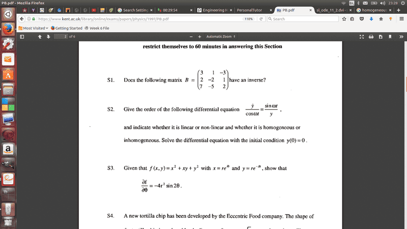

Hi guys, I am having a bit of trouble with this question:
S2. It the linear non linear and homogeneous parts. I think it is a linear equation, as I always think dy/dx (y)=H(x), but is there a way to show this, also for non linear cases. I believe the second part to this question my ans in Inhomeogenous, but once again is there a mathmatical way to show this. I know its not asking for that in the question but for future ref. Also I is omega a constant in this?
For S2 to be linear, we must be able to express it in the form ##Ly=f(t)## for some linear differential operator ##L## and function ##f##. Can you do that?
Re homogeneity: first express the equation in the form given here. Having done that, what are the functions ##M(y,t)## and ##N(y,t)##? Are they both homogeneous?
