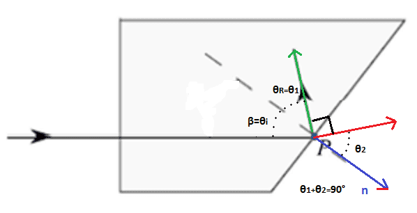

Unpolarized light is reflected internally in the point P in a glass prism. When the prism is located in air, β is the critical angle of total reflection.
I am going to calculate for the following problems:
a) If the prism is submerged into water the reflected light becomes completely linear polarized. Determine the refractive index of the glass at the current wavelength.
Assume that the water has the refractive index nv=1.33 and that the refractive index of the glass prism is greater than this(ng > nv).
b) Does the result in a apply to light with arbitrary wavelengths? Why?
c) Assume that you only have access to diamonds instead of glass prisms. Can you make a similar experiment as in task a? Find out a typical refractive index for diamond when the light has the wavelength λ = 550nm.

Alright, here is my first attempt at a solution:
Because the ng > nv, the outgoing beam of light will be reflected away from the normal of the plane(blue arrow).
Some of the light will leave the prism(refracted light) and some will be reflected(reflected light). If the angle of the refracted and reflected light is equal to 90°, then the light that is reflected will be completely polarized.
I need to calculate the Brewster angle. The angle where the incident light results in the 90° angle between the refracted and reflected light.
I have made notations in the image below, where the green arrow is the reflected light, the red is the refracted light and the blue is the normal to the plane of the prism.
Unknown is ng.
I know that θ12=90°
Using the snells law: ng*sin(θ1)=1.33*sin(θ2)
=> ng*sin(θ1)=1.33*sin(90°-θ1)
=> ng*sin(θ1)=1.33*cos(θ1)
The θ1 should be equal to our β.
So the solution for the refractive index ng, should be ng*sin(β)=1.33*cos(β)
<=> ng=1.33*cos(β)/sin(β)
But I don't think that our β is correct, sine that is the β when the our nv is air...
Need some help here..
No need to help me here. Think I have solved it myself. I can post the solution tomorrow
