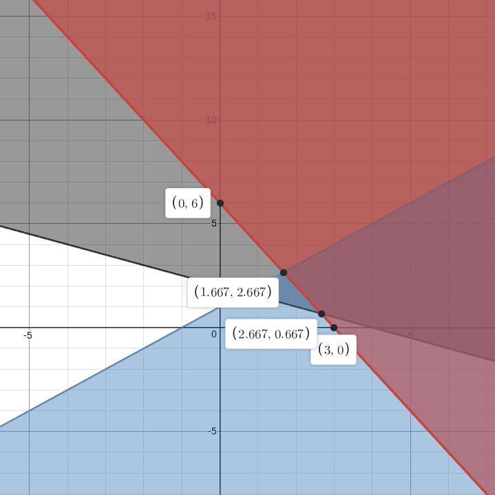

If you really do want to use the two-phase method, you need to introduce artificial variables in the first two constraints (in order to have terms like +x on the left, so you can get an initial feasible solution. However, we want to see if a feasible solution is available in which all the artificial variables equal zero. So, the question is:
given
$$\begin{array}{lc}
x_1+x_2-x_3+a_1 &=4\\
2x_1 - x_2 - x_4 + a_2 &=6\\
-x_1 + x_2 + x_5 &=1\\
x_1,x_2,x_3,x_4,x_5, a_1, a_2 &\geq 0
\end{array}$$
can we find a solution in which ##a_1 = 0## and ##a_2 = 0?## Clearly, if we find a solution with ##a_1 = a_2 = 0## we will have found a feasible solution to the original problem. On the other hand, if every feasible solution of the "artificial" problem involves ##a_1 > 0## or ##a_2 > 0## that would mean that the original problem does not have any feasible solutions (in other words, is an infeasible problem).
The standard Phase-I problem is to find a feasible solution of the artificial problem with all artificial variables equal to zero, or else to show this is not possible. This is done simply by minimizing ##a_1 + a_2##. So the phase-I problem is
$$\begin{array}{clc}
\min & a_1 + a_2 \\
\text{s.t.}&x_1+x_2-x_3+a_1 &=4\\
&2x_1 - x_2 - x_4 + a_2 &=6\\
&-x_1 + x_2 + x_5 &=1\\
&x_1, x_2, x_3, x_4, x_5, a_1, a_2 &\geq 0
\end{array} $$
An initial feasible solution to this problem is ##a_1 = 4, a_2 = 6, x_5 = 1.## In order to proceed towards minimizing ##Z_1 = a_1 + a_2## we need to eliminate the current basic variables ##a_1, a_2## from the objective. We have
$$Z_1 = a_1 + a_2 =(4-x_1-x_2+x_3) +(6-2x_1+x_2 + x_4) \\
= 10 -3 x_1+x_3+x_4$$
Now proceed as usual to minimize ##-3 x_1 + x_3 + x_4## in the artificial problem,

First of all i would like to thank for the answer. But i was still confuse of how to find executable basis for
min $$u=x1+x2$$ or $$u=-x1-x2$$ (?)
although it can be seen from the picture that the executable basis is the extreme point of feasible region
