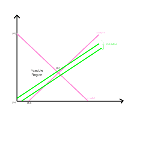

Minimize |2x1-3x2|
subject to
x1+x2≤5
-x1+x2≥-1
x1≥0, x2≥0
(a) Solve the problem graphically.
(b) Formulate a linear program that could be used to solve the problem. Use software to solve your LP and show how to reconstruct a solution to the original problem.
I started graphing the problem and posted an attachment of what I have. I usually solve these by way of the corner point method (just to check that my graphical method is correct), but once I found my corner points for this problem I found that 2 of them have the same value but are not adjacent CPF solutions
(0,0)=0
(1,0)=1
(3,2)=0
(0,5)=15
This is what's confusing me... also, how would I show the graphical method when absolute value is involved? I started to try it, but I would like to know if I'm doing it correctly before going further.

Alright, here is my graphical analysis:
optimal value = 0, occurs at (0,0) and (3,2)
is this correct?

I don't understand your question. The optimal X' will be the minimal value of |2x1 - 3x2|; after all, it is >= both (2x1 - 3x2) and -(2x1 - 3x2), and you minimize it.
RGV
But I'm trying to solve it using IOR and I can't have a function with absolute values I thought?
You don't have any absolute values any more---that was the whole point of introducing the new variable X'.
Watch me compute |-3| without using absolute values:
min z
s.t.
z >= 3
z >= -3
Solution: z = 3.
RGV
