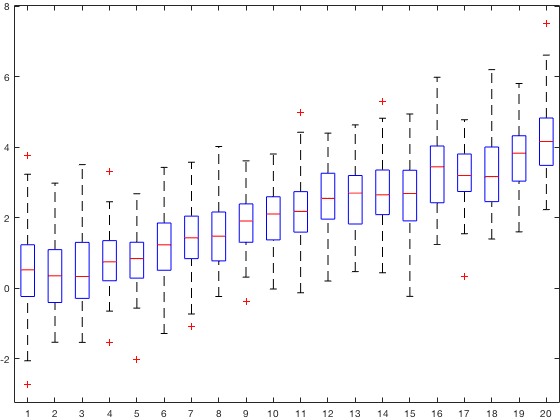

So just to be clear on the problem. Think of the independent variable as time and I have 27 time stamps. At each time stamp I have 50 data points for the dependent variable (i.e., at t=1, there are 50 data points that are continuous, same at t=2,...,27). This can be imagined as a sequential box plot. My question is: What is the best method to fit a line through all my data? And how should I quantify the goodness of fit?
My thinking was to fit through the medians of the data at each time stamp. But perhaps it should be mean... I’m not sure. Further I don’t know how I can communicate a goodness of fit. Thanks again for the help.

Unfortunately, I don't think I'm being clear, and admittedly my title does not convey the actual problem.
My issue isn't on regressing with discrete variables per se, but with the combination of discrete independent variables and continuous dependent variables. Typically in regression one has a set of data points (dependent variables) with one-to-one correspondence to independent variable, {xi, yi}. Inn multivariate regression, you will have a vector of independent variables that correspond to a single dependent variable, {xi, yi}. However, in my problem, I have a single independent variable that corresponds to a vector of dependent variables, {xi, yi}. As an example of the data, consider the attached figure with (standard) normally distributed data plus a linear offset.
So, what is the best way to perform a linear regression through this data, and what is the best way to evaluate said linear fit? Should I simply take the mean or median of the data and then perform linear regression between those two variables? Is there a way to achieve a robust fit through all the data, minimizing the residuals over all the data?

As long as the independent index has some linear meaning, that does not present a problem for the regression algorithm. It will give you an estimator of the dependent variable based on the dependent variable. You can plug in any continuous value between 1 and 20 and get an estimate.
What you want to avoid is an independent variable that is just a label for a set of data with no real association with time. Like 1=>time 10, 2=> time 0.5, 3=> time 12, etc. That would be bad. As long as the index linearly reflects time, it will be ok. Like 1=>time 10, 2=>time 12.5, 3=>time 15.0, 4=>time 17.5, etc.
If you have all the data, it is better to use that. Otherwise, the mean would be ok if all the sets have the same number of data points. If the sets have different amounts of data, the means should be weighted by the different amounts of data. You might not get very meaningful results from using a median or mode.

I do have all the data. In what way should I use all the data? Is there some bootstrapping method or performing multiple regressions over randomly chosen data?
There is not really anything special to do. Just perform a simple linear regression on all the data.

I have trouble seeing this as a regression problem. If the LH predictor variable is a discrete time measurement, like the hour of the day, what use is a function of that arbitrary number for predicting out of sample? The typical time series regression tries to discern a linear relationship between a set of time-ordered values relative to a set of predictor variables measuring something else over the same period (perhaps with lags), but not the number of periods itself. Your model would need some plausable relationship between the actual discrete time stamp and the RH variable. What casual relationship are you trying to discern between these two?
The box plot does a great job of showing the range of data over time, nor sure what of value a regression would add to that
The other thing to look for with time ordered data is autocorrelation. If the value of y at time tn is correlated with the value of y at time tn-1 then the t-values will be overstated. There are a number of techniques such as GMM to correct for this.
