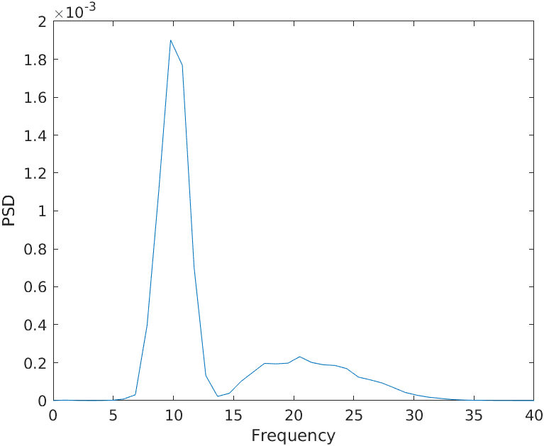

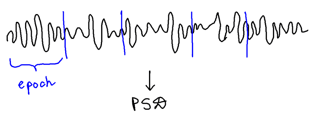

Suppose I have a time series, divided into some epochs. If I compute PSD by Welch's method with a time window equal to the length of an epoch and without any overlap, I obtain this result:

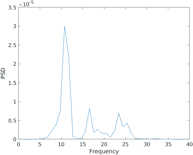

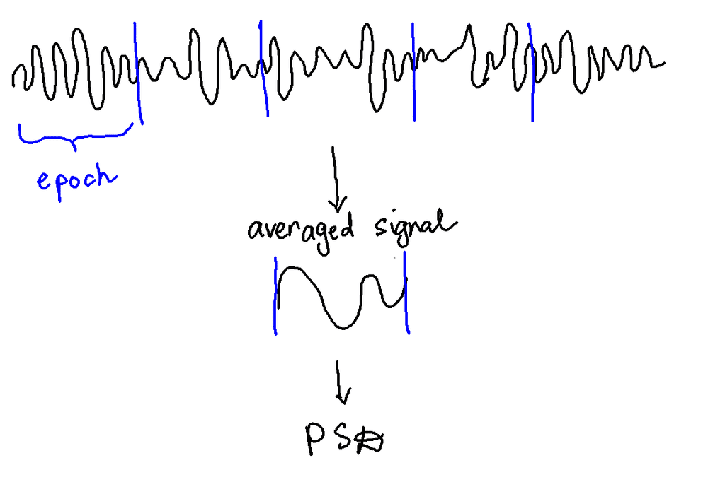

If I calculate the average of my time series over the epochs, obtain the averaged signal, the length of which is equal to the length of one epoch (obviously), and then compute PSD by the same method using this averaged signal, I get a slightly different result:
I thought that these two scenarios could not be different, as PSD from the concatenated epochs is presumably equal to PSD from averaged epochs (in my opinion). However, the results are different.
I am looking for analytical explanation of these discrepancies.

Scenario 1. I have a long time series made of concatenated epochs. Then I compute PSD.
Scenario 2. From the same epochs I compute the average and then compute PSD.
In Scenario 1 we have averaged PSDs from each epoch, because the time window in Welch's method I set as the length of the epoch. In Scenario 2 we have PSD from the averaged signal. It seems that they are not equal, as evident from the plots in my initial question. But I don't understand why...

To add insult to injury I didn't understand the scenario: I figured PSD versus average of epoch PSDs instead of PSD of epoch average.
An averaged signal ruins a power spectral density: the average of a nonzero signal can be zero in a worst case
