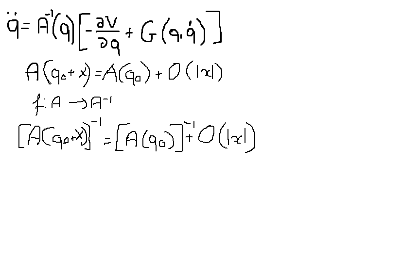

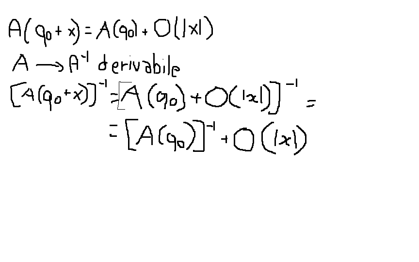

l am italian student from Milan university, so sorry for my bad english.
l am studying lagrange meccanics. We are linearizating lagrange equations. Here l don't understand how you can expand A matrix, how the function f is derivable, how the inverse matrix A is expanded? l am expanding with q0 center, x is the small displacement . G is a quadratic form.
O(|x|) is order of magnitude
Likes Delta2
Do you mean, $$G(q,\dot q)=\sum_{ij}A_{ij}~q_i\dot q_j,$$ is linear in ##\dot{q}_i##? Or,
$$G=\sum A_{ij}(q)\dot{q}_i\dot{q}_j$$
Likes PhDeezNutz
Can we assume anything about ##A##? Is it symmetric?
L = T - V ## T = \sum a_{ij}(q) q'_i q'_j## $$ A= [a_{ij}] $$
## G_h(q,q')= \sum_{jl} \frac {\partial\a_{hj}} {\partial q_l} q'_l q'_j + \sum_{ij} \frac {\partial\a_{ij}} {2 \partial q_h} q'_l q'_j##
but l am interestin how to expand ## [A(q)]^{-1}## with ##q_0## as center
Likes PhDeezNutz
A is symmetri...
it is kinetic energy matrix
L is a natural lagrangian
Likes PhDeezNutz
