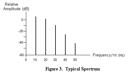

Right now, I still can't really link the vector diagram of complex numbers to the plot of amplitude-frequency of waves, I think. >< The latter, from my point of view, is a diagram of spikes coming out at different frequencies, depending on the original wave.
Ah, you mean the amplitude spectrum, e.g:
But that's just a plot of ##|V(f)|## over some interval of ##f##, i.e. it's a plot of the modulus of ##V(f)##. In some contexts, you also include the phase spectrum, which is just a plot of ##\arg(V(f))##.
Does that help?
Does that help?
I see. Yupp, I meant that. Haha. That was the diagram shown in my lecture notes, so I can link to it better. :)
