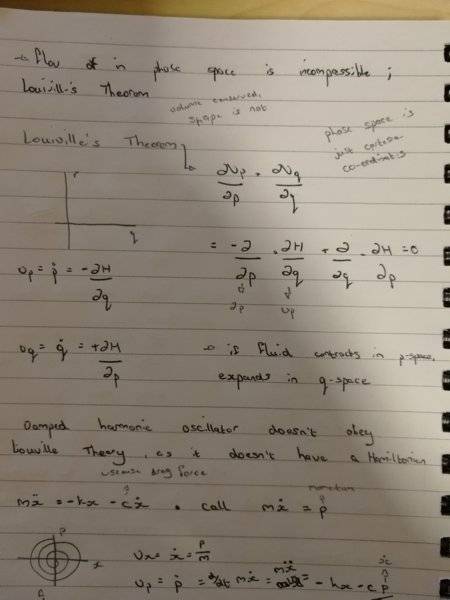

I've a general question. I'm self-studying classical mechanics using various means one of which is Leonard Susskind's Theoretical Minimum lecture series.
I'm on Lecture 7 and we are doing Liouville's Theorem. My understanding of it so far is that in phase space as something expands in, say, the x-direction, it must contract by an equal amount in the y-direction. This is no different in 3-D.
A question was asked in the lecture if this theory holds for the expanding universe. The answer was given as yes. This would thus mean that the universe is expanding and contracting at the same time, which obviously does not make sense. I presume I am just viewing this all wrong so what is the "answer" so to speak? How does the theorem still hold?

Liouville Theorem states that in phase space volume is conserved, provided the system can be described using the Hamilton ion formulation. So volume is conserved however the shape of the system can change ie if the system was a fluid, the fluids shape can change but not its volume.
I've uploaded pictures so you can see the basic maths.
In the lecture I gathered Leonard Susskind said that Liouville's Theorem hols for the expansion of the universe i.e it's volume is constant. I just don't understand how this could be?
That's oversimplifying. Phase space has 3 position and 3 velocity degrees of freedom for each particle in a multi particle system. It is the volume of that multidimensional space that is conserved.
Susskind said that he was attempting to explain using a 2D whiteboard. By analogy only, the 2D area on the whiteboard is conserved as time evolves.

Ok but in his explanation he said that as the q-space increases, the p-space (momentum) decreses. And he says that this holds true for the expanding Universe. Thus the overall momentum of the Universe must be decreasing. I'm guessing that the Theorem is maybe too simplistic to be applied to the expansion of the Universe? Or is it that it can only be applied to certain particle systems as oppsoed to Universe as a whole?

I think the answer lies in the difference between motion through space and the expansion of space. That is how distant galaxies can recede from us faster than c without any FTL motion.
In phase space, yes. But in phase space, in "1D", if the "x" direction is position, the "y" direction is momentum. (In "3D", phase space is 6-dimensional, not 3-dimensional.)
Also, "something expands" is vague. What the theorem actually says is that, if you pick a set of points in phase space at a given time, the set of points that those points evolve into over time keeps the same volume. But the set of points does not have to remain convex or even continuous.
Finally, the formulation of Liouville's Theorem you're describing is for classical, pre-relativity mechanics. I'm not aware of a formulation that works for general relativity. So I don't think you can apply it to our expanding universe, since that requires GR to describe.

Can I ask what you mean by convex in this context? Although that helps, as I thought the set of points did have to remain continuous, and could not "break away" from each other as such.
This is one of those times when I really wish Susskind would be more precise. You can apply the theorem locally to a portion of the universe. But I'm not aware of any formulation that works for the universe as a whole.
Just what your intuition would think: that the region in phase space occupied by the points is convex. Heuristically, a straight line connecting any two points should not go outside the region if the region is convex. But the region in phase space occupied by the points does not have to have this property.
The whole set of points in phase space occupied by the system at all times, not just one instant of time, probably does meet the technical definition of "continuous". But AFAIK there is no requirement that the set of points in phase space occupied by the system at one instant of time must be continuous for all instants.
