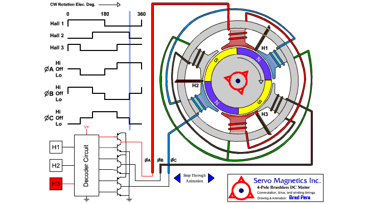

It would seem that your design stands or falls on the availability of suitable 'brush' replacements. It seems there is nothing that will do the job so perhaps you should consider a completely different approach.
One way to describe a brushless motor is "AC synchronous motor with a permanent magnet field on the rotor" The "AC" is generated by switching the DC in a pattern.
http://www.set-tech.com.tw/en/bldc-motor-control.html said:
They are not just small motors, here is a 20 KW one. https://www.alibaba.com/product-detail/High-Efficiency-BLDC-motor-20KW-electric_60500835073.html
