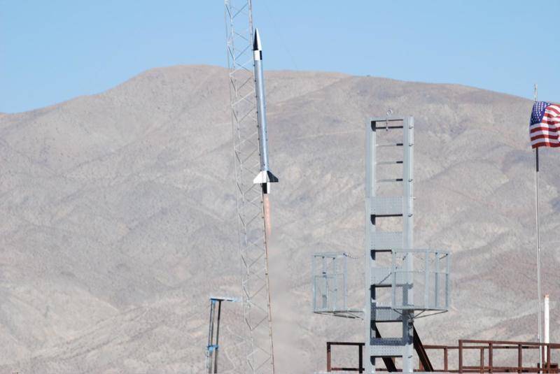

Several years back now I built a fairly large (for amateurs) liquid rocket engine and eventually flew a vehicle with it. A video of that flight can be seen here : http://vimeo.com/54742023 Please forgive the video quality.
Are you just working on a gas generator or do you see it integrated with a larger engine? The reason I ask is you can build a very large rocket engine that is pressure fed with a simple helium tank. For smaller engines, a gas generator is a little over kill unless you plan on using it to run a pump. However, working with turbo machinery adds drastically to the challenge.
Remember when working with pressurized oxygen or liquid oxygen you have to maintain a strict O2 clean policy for everything. All tools, hoses, fittings, pipes, valves have to be O2 safe. It only takes a little contamination to blow things apart in a bad way. It's good to be paranoid about cleanliness when working with oxidizers.
