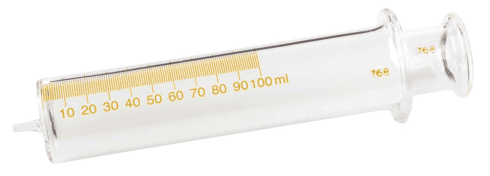

A.T. said:
(plastic/rubber deformation) makes pulling a syringe jittery.
It wouldn't happen with a Gas Syringe, I'm sure. A gas syringe has strong glass sides and a cylindrical glass piston with a deep ground glass seal.
