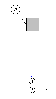

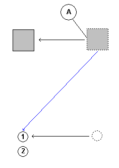

And another thing that I considered quite interesting (somewhat related to relativistic interpretation of aberration). This is actually a paradox kind of thing but it of course is related to some misconception (if you have it).
Let's say we have situation like this:
Observers "1" and "2" are observing box with an "A" printed on it's side. We view this situation in rest frame of the box and first observer. Second observer is in motion in that frame. Neither observer can see the "A" on the side of the box when both observers are side by side.
Now let's change to rest frame of second observer:
The box and first observer is in motion in that frame. Because the box is in motion and light doesn't get to observer instantly second observer see the box in it's past position. So should the "A" be visible for him?
