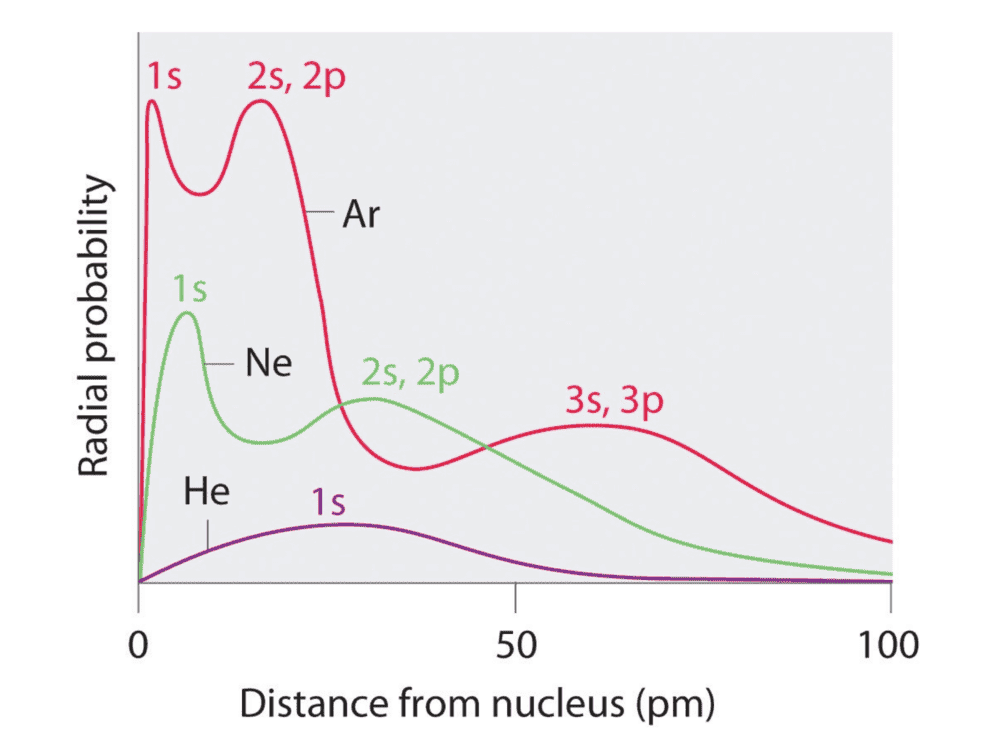

I just wanted to add a comment that looking at the paper referenced above it seems that even with only a 'few' parameters, there seems to be a few dozen terms in the wavefunction counting permutations and spin. Ultimately it would be interesting to reduce it to a function of total electron cloud probability density as a function of distance from the nucleus such as in the image below however I suspect this plot was constructed from one-electron wavefunctions.
We have no way of assessing that unless you give us a reference for where the image came from (hint, hint...).
Likes bob012345
Sorry. Here it is. I may have been hasty in concluding it was based on single electron wavefunctions. I can say I plotted the sums of probability densities from such hydrogenic wavefunctions and got a very similar plot.
https://chem.libretexts.org/Courses/Saint_Marys_College%2C_Notre_Dame%2C_IN/CHEM_342%3A_Bio-inorganic_Chemistry/Readings/Purgatory/D._Sizes_of_Atoms_and_Ions
bob012345 said:
Here it is.
Unfortunately, Firefox appears to insist on removing the apostrophe in Saint Mary's from the URL, which understandably gives a page not found error. (Technically the apostrophe should be URL encoded, so the URL is not correct according to web standards, but in the real world there are far too many URLs out there that break those standards for insisting on strict compliance to be realistic.)
I was able to get to the page from this search:
https://chem.libretexts.org/Special...fpth=&query=sizes+of+atoms+and+ions&type=wiki
Clicking on the second link works for me.
Likes bob012345
It says "total electron density for all occupied orbitals", which looks to me like it is doing the following:
(1) Start with the wave function for each orbital for the given atom that is occupied in the ground state. This will not be precisely the wave function for that orbital for hydrogen, because of the different nuclear charge and shielding from electrons in other orbitals, but it will generally look reasonably "hydrogenic" in qualitative form.
(2) For orbitals that have nonzero orbital angular momentum (i.e., all except ##s##), average over all angles to remove the angular dependence and obtain a function of radius alone.
(3) Multiply each orbital radial function by the number of electrons in that orbital in the ground state (which will be either 1 or 2--note that this particular graph only includes noble gases, which have completely filled shells so all orbitals have 2 electrons).
(4) Add the radial functions for all the orbitals together to get the total electron density as a function of radius.
There is no math on the page so I can't be sure of the above, but that's what makes sense to me.
Likes bob012345
Thanks! That seems very reasonable. I didn't think it was the actual multi-electron wave-functions since it seems extremely difficult to solve much past Lithium directly. I'm going to try it and hopefully, return a plot to compare the other one to. Obviously, wave-functions for multi-electron atoms aren't exactly the same for single electron hydrogenic atoms. Helium, for example, with two electrons has a very slightly larger radius (peak probability as one measure) than with one electron. One technical question in regards to the overall probability density is whether to add individual densities or add all the wave-functions first and then square? Thanks again.

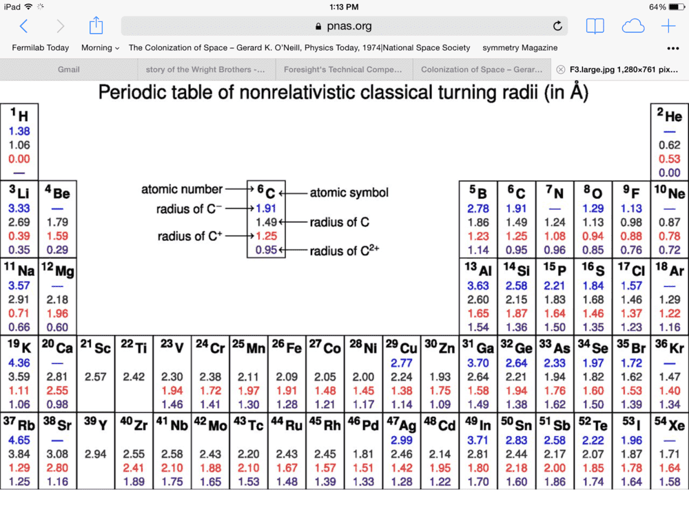

Do you mean a Helium+ ion (one electron) as compared to a neutral Helium atom (two electrons)?
Likes bob012345
Yes. Here is a reference which contains the following chart. Notice the relative size of He+ to He which is about 17% larger. This would mean a full 1s shell would have a slightly different peak than a hydrogenic orbital function derived from a one-electron Schrodinger equation and so forth up the chain. But still maybe it's close enough.
https://www.pnas.org/content/115/50/E11578
This is a chart of "non-relativistic classical turning radii", which is a different concept of "size" than your previous reference was using. For one-electron atoms/ions, this is simply twice the radius of the peak of the 1s orbital wave function (you can see this from the value for hydrogen, which is twice the Bohr radius of 0.53 Angstroms--then He+ and Li++ are one-half and one-third of the hydrogen value, as expected from the nuclear charges of 2 and 3 vs. 1), which is twice the value of the previous "size" concept. But for atoms/ions with multiple electrons, I don't know if the same simple relationship holds.
Likes bob012345
Just on general principles, I would expect removing one electron from any neutral atom to leave a positive ion that is smaller. Once the first electron is removed, the binding energy of the most loosely bound one that remains will be larger than the binding energy of the one that got removed (i.e., the energy it took to singly ionize the atom), and "larger binding energy", heuristically, means "closer average distance of electron from nucleus", i.e., a peak of the electron radial wave function at a smaller radius.
Similarly, I would expect adding an electron to any neutral atom to give a negative ion that is larger, since the new electron will have to be in a more loosely bound state than the ones that were there in the neutral atom. (Of course this assumes that the neutral atom started off in its ground state.)
How much of an energy difference there is in these cases will of course depend on the details of which atom, which shells are filled, partially filled, etc.
Likes bob012345
Thanks. Every chart seems to have a different way of calculating the effective size of atoms and ions but the relative differences are useful. From the chart above, the size ratios for Li+ vs. Helium is not quite the same as for Li++ and He+. $$ He^+/Li^{++} ≈ 1.51 ~~vs.~~ He/Li^+ ≈ 1.59$$

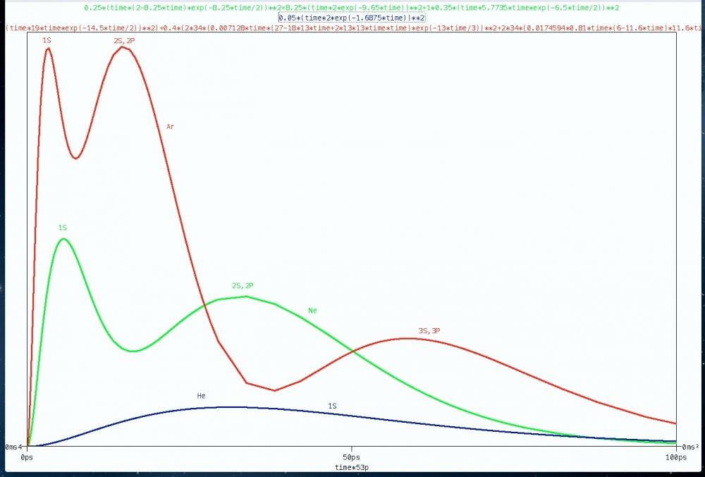

Here is my attempt to do your suggested procedure. The original plot is included for reference. Since the original plot looked to me that it might be a drawing for a textbook, I wasn't sure how accurate it was. The main conclusion I can make is that the greatest factor is an estimation of the screening by changing the nuclear charge to an effective nuclear charge. I started with my old QM text's Zeff for Helium (1.6875). In the analog computer simulation, time is distance. The horizontal scales are 0 to 100pm on both and are distance from the nucleus. The vertical scale is radial probability in arbitrary units. I did have to tweak the relative strengths of the wavefunctions a bit to get the right relative amplitudes but the normalized wave-functions were in the ballpark. I used Zeff to get the right shapes as a function of distance.
