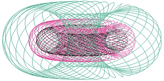

If you do a Google image search of the Hopf fibration you will get many pictures where we see the fibers by sterographic projection but I wanted to see these fibrations as a person stuck inside a three-sphere might see them examining some small region where space was roughly flat. So with your help I think I have a better picture of what is going on, no paint needed. Please correct me where I go wrong.

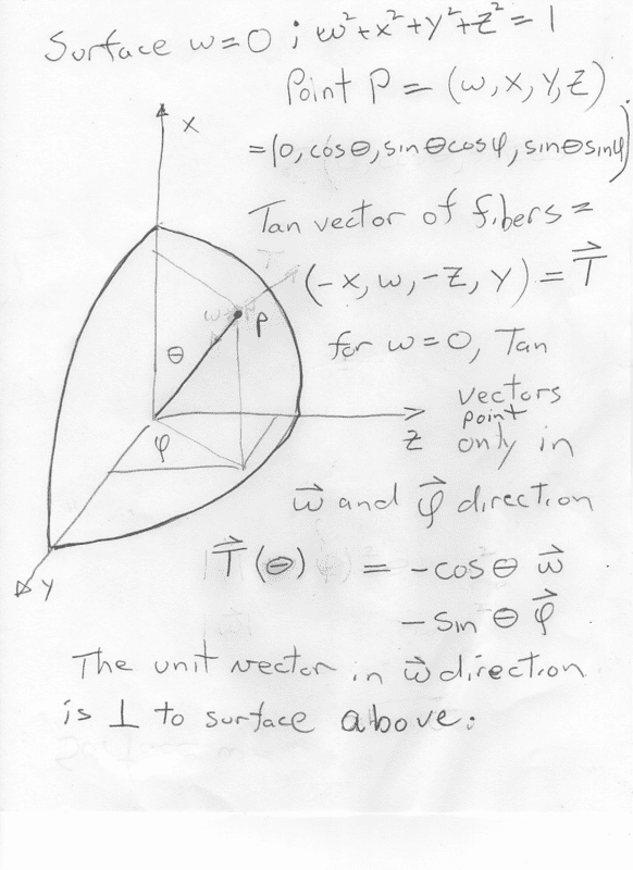

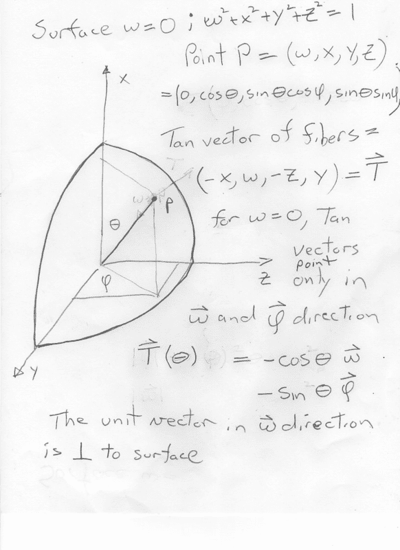

So with some thought and the tangent vector field given in post 2 I think I have what I was looking for, the tangent vector field of the fibration at the surface w=o. See the sketch below.
A hard part was understanding that the unit vector in the w direction was perpendicular the surface w=o as graphed above. Mistakes pointed out appreciated. Thank you for everyone's help.
Edit, If T = (-x,w,-z,y) is a valid tangent field then T = (-x,w,z,-y) is also valid with opposite skew?

@Spinnor Using your notation in post #15
If ##w=0## then T=(-cosθ,0, -sinθsinφ,sinθcosφ)
Note that as cosθ approaches zero T becomes tangent to the equator (0,0,y,z)
Likes Spinnor
As it must?
Spinnor said:
As it must?
Yes. The tangents to the fibers vary continuously and the equator is a fiber.

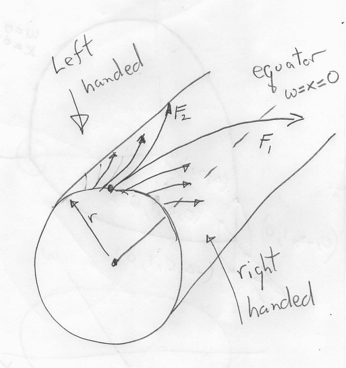

I have graphed some of the tangent vectors near the equator graphed above in post #15 and the vectors given by T and T' above seem like they suggest that the fibers "wrap around" the equator with opposite handedness? This to me seemed to give rise to a handedness for each fibration given by T and T'.
My hunch is that if I sit in S^3 and hold a left handed helix in my left hand and hold a right handed helix in my right hand no set of rotations of S^3 sitting in R^4 can change the handedness of one helix into another?
Thanks for your help.
I think the above is correct but now I am not so sure I am graphing vectors correctly, have to think about this more.
I am doubting the tangent vector field I gave above works, T', but I still think there is one that does what I want, give a fibration of opposite handedness to T? But I could be mistaken.

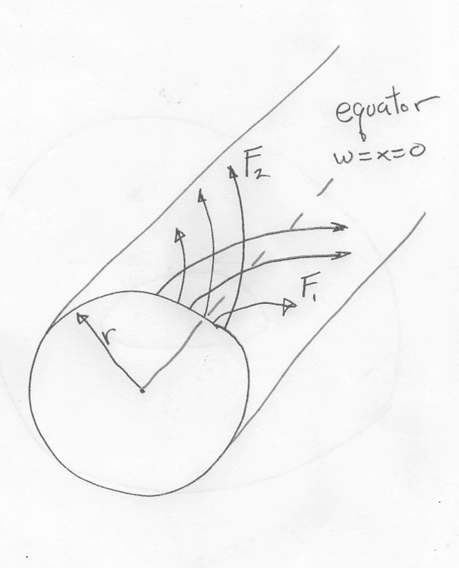

Consider the equator graphed above in post #15 above given by x=w=0. This is a fiber of S^3. Imagine the small radius torus that surrounds that fiber and is "equal spaced" around that fiber, this torus is a subset of S^3. The surface of that torus can be fibered two ways?
If I travel along the equator I can imagine the torus that surrounds the equator and myself and which is fibered two ways suggested by the sketch below.
Thanks.
