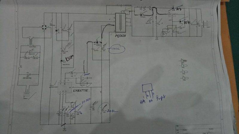

Hello . I am trying to make power supply using LM317T. As i need Variable output voltage from 14 V to 27.6 V.
I made a power supply of 29V/1A using Power Integration IC LNK6775E. At the output of 29V i am using LM317T to vary voltage.
But after 5 minutes IC is going in protection mode if apply a load of 1A and set output voltage to 14V.
I am also using Heatsink, but there is too much heat.
How to control this heat.
And is it reliable ?

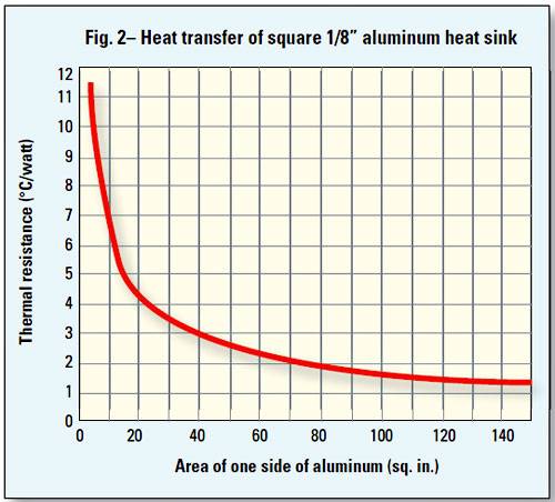

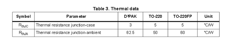

15 volt drop at 1 amp is 15 watts
To hold temperature rise to 100 degrees you need thermal resistance junction to ambient of 100deg/15watts = 6.67 deg/w or less
and observe 5 of those are used up internally
leaving only 1.67 for case to ambient which is your heatsink.
http://www.st.com/content/ccc/resou...df/jcr:content/translations/en.CD00000455.pdf
to keep temperature rise less than 100 degrees you need a heatsink that can beat 1.67 deg/watt.
Here's a snip from
about a square foot of 1/8 " aluminum should do nicely.

You also made a regulator that's 50% efficient, which is not good.
Why not just use the LNK6775E for your voltage regulation. I'm assuming you are using a potentiometer or similar variable resistor in the feedback path on your linear regulator. Just include the potentiometer on your LNK6775E instead. you already have feedback resistors, that how you get the 29 volts. just redo your calculations to determine the resistance swing and tolerance you need.

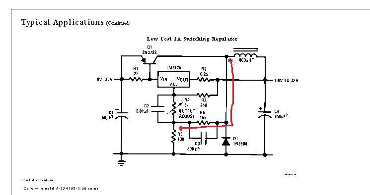

For just a one-of-a-kind home project,
Try a search on "LM317 as switching regulator"
the old National datasheet from before TI took them over had this image
i never tried it so don't know if it's well behaved.
Likes davenn and dlgoff
I don't get it. What switches?
If i understand the circuit,
this positive feedback path gives it enough hysteresis that Mr LM317 will oscillate between full-on and full-off.
For lower current i wonder if the inductor with a series diode could be moved down to R2's position , eliminate Q1 & R1 ?
I don't know, just speculating.
As i say i never built one. Looks like an easy introduction to switchers and inductor sizing, though.
